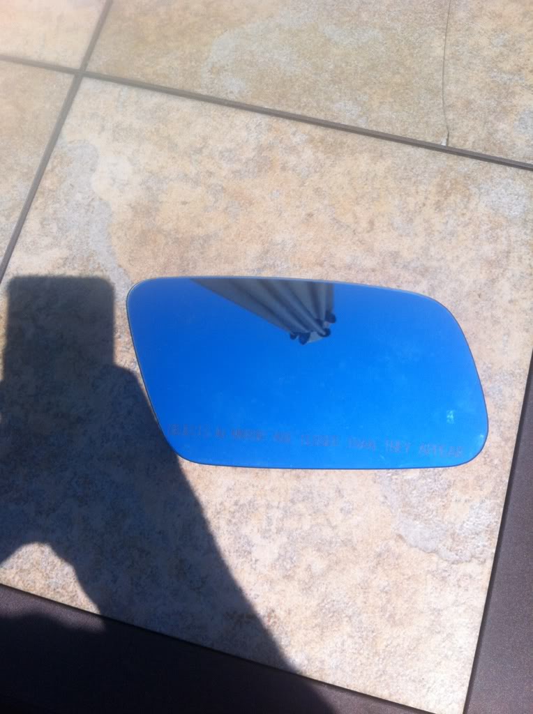

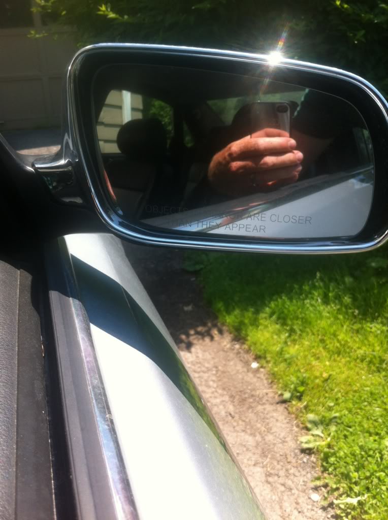

Facelift glass is shaped differently than pre-facelift (even the full-size glass). Here's pre-facelift:

Here's facelift:

The main difference is the edge closest to the window. Preface is vcloser to vertical, and facelift is angled to match the "lean" of the window. B5 Passat and C5 A6 glass match the preface A4 glass. A B5.5 (facelift) Passat or later A6 might match yours, but I don't know for sure.
