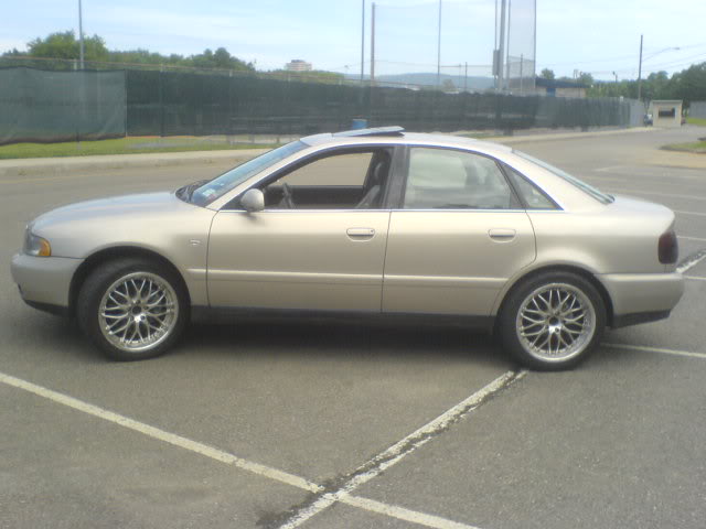

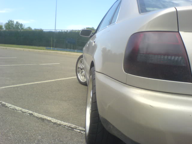

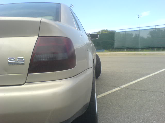

i'm running 6mm spacers all around because i can't fit 18x8 wheels with 245/40 tires under there. no the tires were not my choice. i've driven my car a couple thousand miles since and haven't had any issues at all. just make sure you have everything lined up so you're not out of balance. i got an alignment after i installed everything too. i also have a ~80 pound system in the trunk with my school books. the rears have camber adjustments but i don't think the front does. the front has toe adjustments though.
here's some pix
