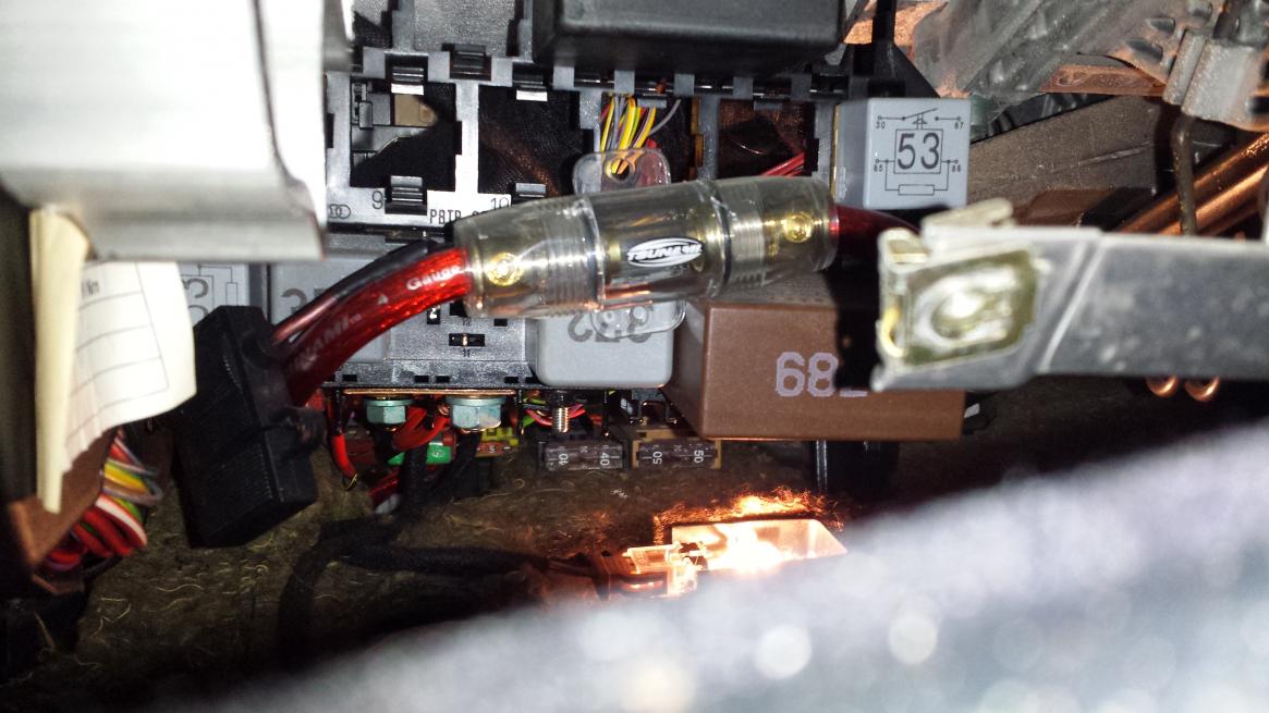

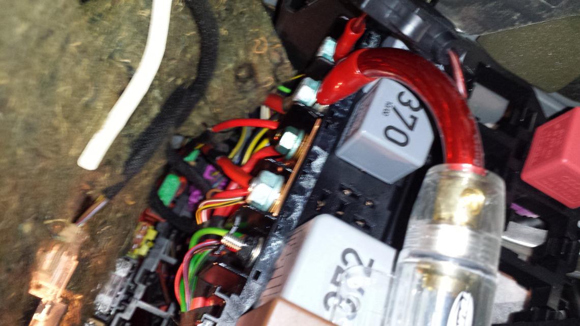

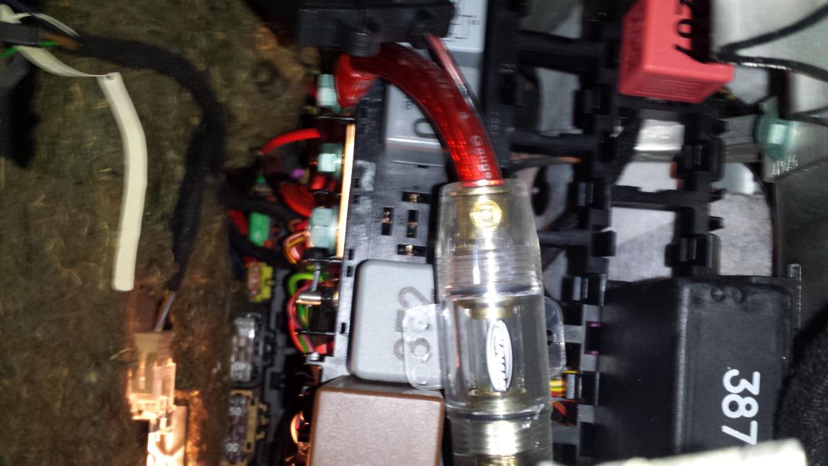

Went to check the relays, the ECU power relay is there, not sure if its ok, but either way I have a new one on the way. I've never looked at my relays before, but it doesn't look like any other pics I've seen, there is some huge mission impossible hacking device in there. pics below. Not sure what exactly this is, but it looks aftermarket, nothing I ever installed.
Hopefully by tom I'll have the ecu relay and CPS and get deeper in to install and figure out what this is. thanks
ok so it is some sort of a Tsunami amp, speaker wire set up, nothing I put in there. It connects just below 372, and then goes toward the front of the car somewhere I can't see.
As I am chasing what might be an electrical issue, I want as little variables as possible, but I may introduce more by yanking it, or it might be the cause of the intermittent issues.

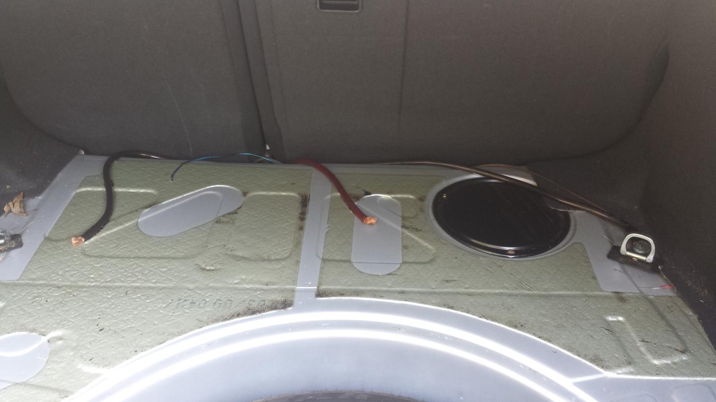

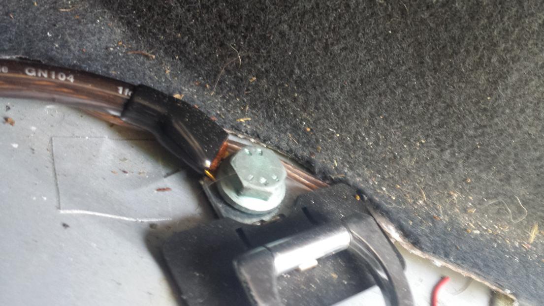

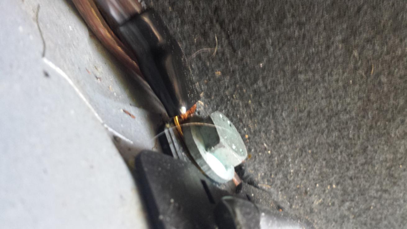

some sort of old connection for amps and subs. had trouble tracing it further than the relay box because of stuff in the way, but checked out the trunk, never opened the floor past the spare tire until now. Certainly used to be amps/subs in there. 5 exposed wires. One goes to the speakers on the passenger side through the trunk wall. The big one on the left is just cut and glued down, middle red same, right brown one is attached to the metal there? Then one small blue one loose as well.
None of this matters to me right now at all, speakers work just fine, I'm just worried all this unfinished craziness could be related to my possible electrical starting/cutting issues
