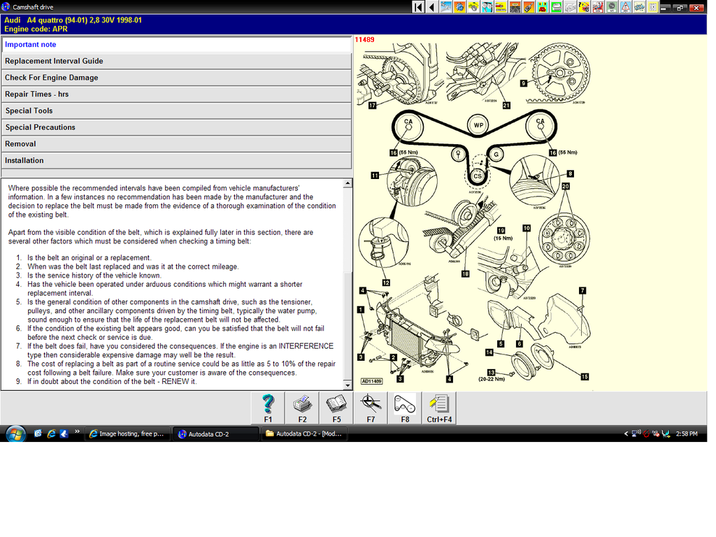

Originally Posted by AudiTurbo
Where I from I got the water pump, timing belt changed in one day for 300 out the door.
It's awesome that you get hooked up, but 1.8t and 2.8 is apples and oranges, not to mention whoever is servicing your car obviously likes to work for peanuts which is a rarity. Your experience is sort of irrelevant and not applicable to statdev's situation in every way. Like said, the parts alone are nearly $300 if the job is getting done right.
Leaky valve cover gaskets and cam seals arent going to make you lose any measureable amount of oil within a short time. It's not like they pour the oil in and then it comes gushing out the very top of the engine where those seals are. They of course will make it sound more urgent than it really is. $800+ just for those things sounds like rape though. The $1350 sounds normalish. A little high. Audi techs love timing belt jobs.
Here is a closer look if you care.
