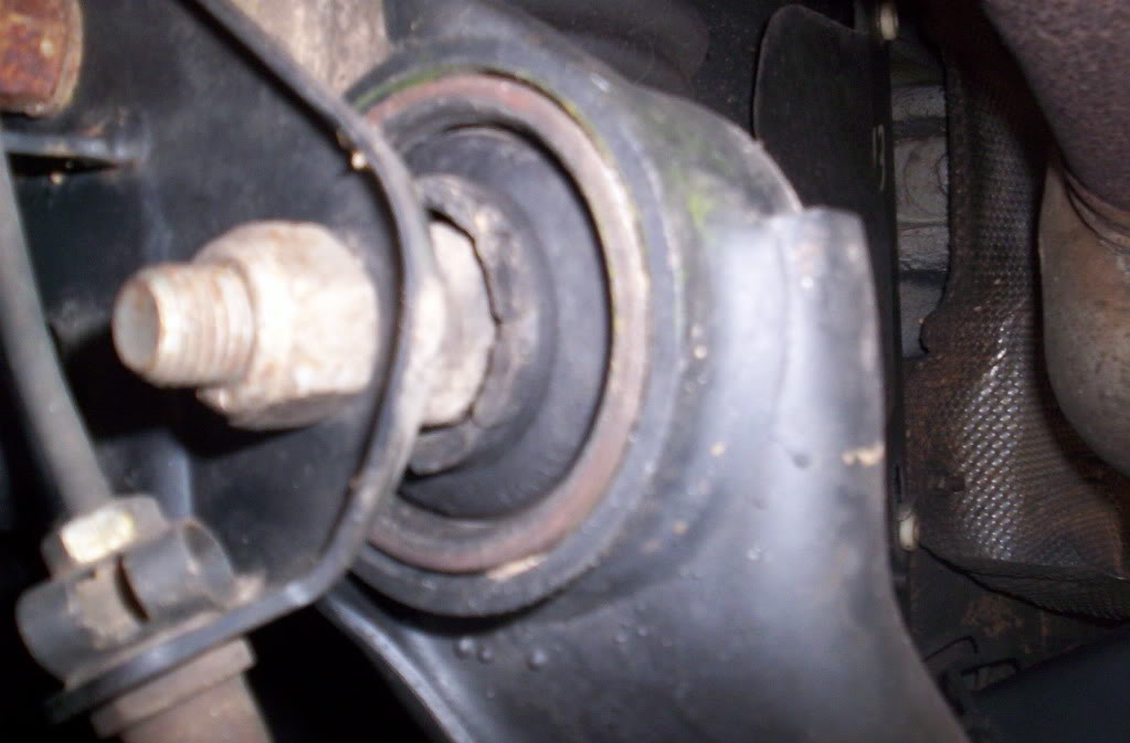

I decided to measure my wheelbase, just as another thing to rule out if possible. The results were a little surprising. I don't remember the numbers, but the left side is 1/4 of an inch longer than the right. What affect would this have on handling? and can it be fixed without spending a lot of money?
I also checked all the rear bushings and this is what I found:
Driver side rear lower control arm rear bushing:
Passenger side rear lower control arm rear bushing:
The passenger side bushing appears to have slightly more play than the driver side one (indicated by the distance from the bolt to the center of the bushing), but still appears to serve its purpose. They didn't feel any different from one another when I pushed on them while the wheel bearing housings were removed.

that washer is not supposed to be conical. i replace all my upper rear bushings in the summer and it made a huge difference on tire wear. the lowers look fine to me. take a closer look at your rear subframe. it might be the culprit
