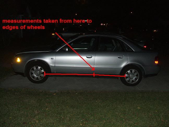

I measured the wheelbase in four different places today. I measured it like this on both sides of the car.
To the front left wheel is 50 17/32"
To the front right wheel is 50 1/32"
To the rear left wheel is 32 9/16"
To the rear right wheel is 32 9/16"
Both rear measurements are identical, which leads me to believe that the rear is fine. The front measurements are half an inch different from one another. This is strange because the left side of the frame was the part that was impacted from the collision and pushed in about half an inch to an inch, however the front left wheel was measured as being half an inch FORWARD of the front right wheel. I've measured it over and over again and can't make any sense of it. Does anyone have any theories as to what happened structurally to my car when it struck that guardrail two years ago?

Um.. to measure wheelbase, measure the centerline of the axles (axle to axle) and not a body panel. You can do this by making sure the wheels are straight and using a plumb-bob to mark the ground (use chalk on asphalt). Then measure the marks front to rear and corner to corner.
I may do that too, to get an "official" wheelbase measurement. The thing is I already measured the distance between wheels and found the left side to be half an inch longer than the right. I wanted to find out whether it was the front or the rear of the car that was different, this was the only way I could think of doing this.
