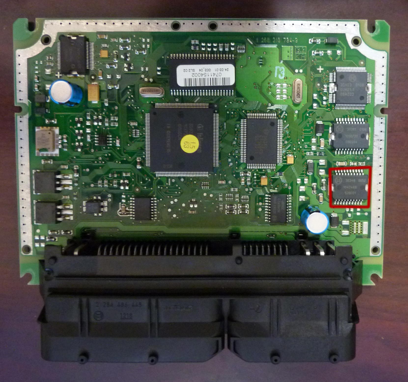

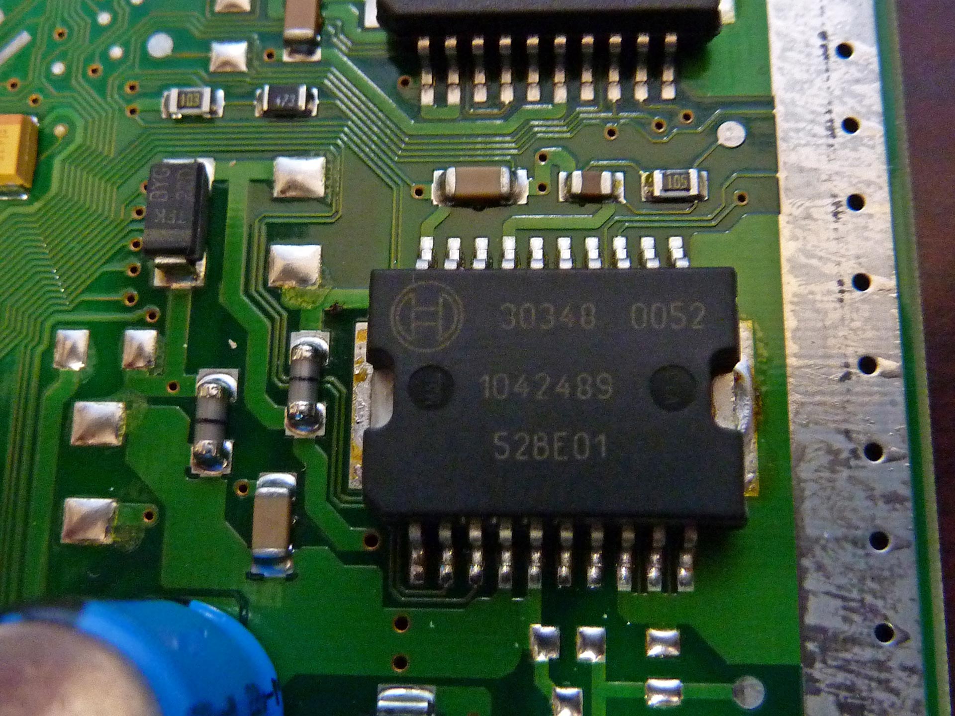

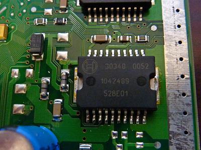

Took the ECU out of the case and checked the chips with a pyrometer. Everything stays within pretty reasonable temperature ranges with the exception of one chip. The chip in the red box gets to roughly 300 degrees F while the car is on. I've included a closeup of the toasty chip.
New ECU is on it's way, just don't want something else to fry the new one if it's something outside the ECU that's faulty.
