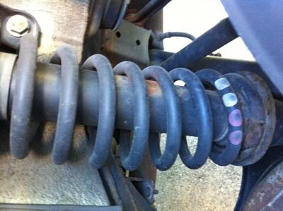

Well we finally got a break from the 95+ degree weather and I took the wheel off to have a look. I think I found the source of the squeak.
The spring is off center and rubbing on the shock. I noticed that the spring is cracked at the very bottom - so I am guessing that is why.
So... the big question is - where can I buy a replacement spring? This is a 98 2.8 quattro - but according to the window sticker it also has a sport suspension package - so where can I find an OEM replacement?
Thanks
charlie

^^ ahh i just remembered thats what my mechanic said with mine when he took it out to install vmaxx coilovers. i suggest you do the same thing =D
