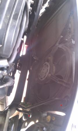

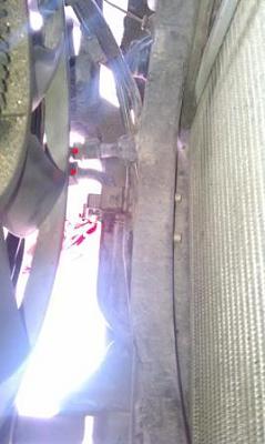

Here is where I am. I have taken off the front part almost completely except that the coolant lines are still on. I am trying to figure out where to take them off ( do I really need to?). I have the manuals and online timing belt DIYs but none of them talk about how to take those lines off. I donot see a way how I can take the front lock carrier off without taking those lines off at some point. I have uploaded the pics.
I have put red dots on the point where the coolant lines connect to radiator as well as where there is a junction in the coolant lines on the drivers side before they hug the radiator and connect into the radiator.
Please take a look and gimme ur 2c!

You can loosen up the radiator and tilt it forward enough to give yourself some space in there. You don't need to drain the coolant or disconnect the coolant lines.
Note that the serpentine belt tensioner is spring loaded with a strong spring. You'll want to lock it in place with a pin of some sort or, preferably, buy yourself a new tensioner.
