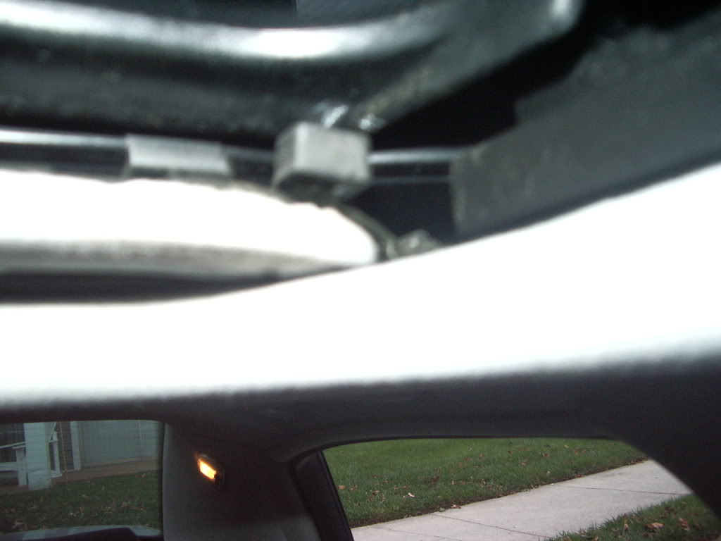

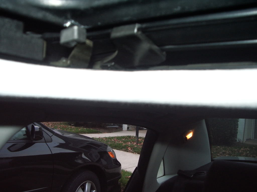

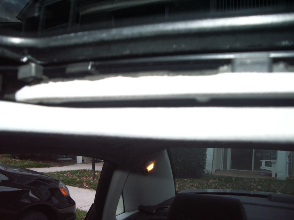

Hey guys, i remember a thread about this topic a while back and i took some pics of my sunroof in the closed position. Mine works just fine. I hope these help!

Sorry for the poor quality, my camera is a POS. Also, if you want me to take pictures of different parts of the sunroof, lemme know i'll see what i can come up with..

I talked to Rob at A&P and he suggested that maybe the roof has come off the rails. But from the pictures posted by CCA4, I think I'm missing the part in red and maybe even the part in blue. I'll go look during my lunch break.
Now, what do these parts do?

near as i can tell, thats what holds the sunroof shut. because when you pop it up from the closed position, those thingys move. please excuse my lack of correct terminology lol. its pouring rain at the moment but if it clears up i'll go out and try to get a video of what happens to those parts when you open the sunroof

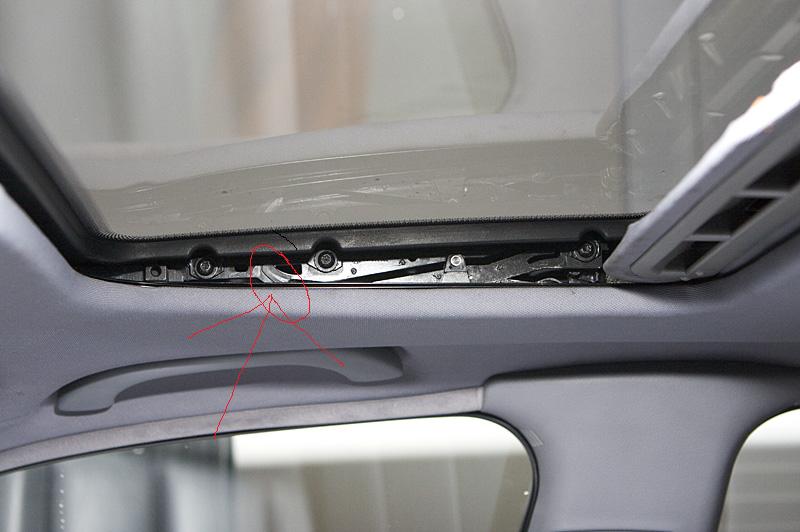

After looking, I think my sunroof is totally different from yours. This is a picture of what I was able to get with my iPhone. I had to open the roof into the "vent" position to see anything.

It looks to me like your track inserts are bad, same problem I have.. and it gets worse when its cold out.. Your track looks worse than mine though. The part that i have circled is made of plastic and is supposed to go along that whole metal track where the pin slides through. When that plastic track breaks it creates alot of play so the roof will rattle.
