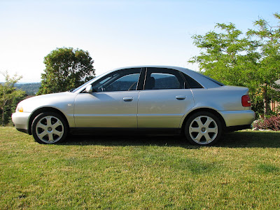

Default Picture of A4 2.8 with s4 springs
S4 will bolt right up to the 2.8 quattro, drop slightly (1/2" to 3/4" inch) from stock and ride very nice (sportier than stock but still very smooth). I put them on my A4 2.8 and the front ended up about 5/8" higher than the rear; this is because the s4 weights a bit more up front.
I'd only do s4 on a 2.8 A4q if you can get a good used set real cheap. I have H&R sport springs on bilstein now and it's a fair amount stiffer than the S4 set up but not as nice of a daily driver on the crappy road I drive.
Decide for your self, here's a picture:

Nice car....
