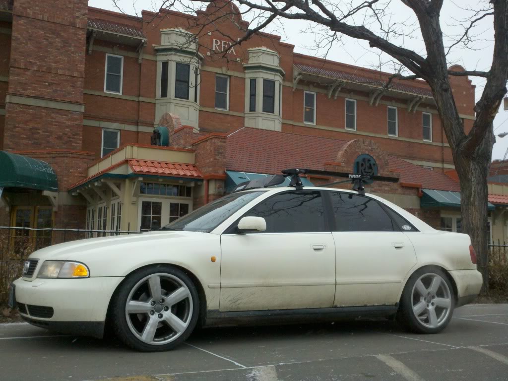

I know that I do have the range of adjustability with coilovers, but I don't see the need. This is a DD that just needs to come down a little bit. I don't see myself in the sub 25 gtf range. I have coilovers on my rx-7 and haven't changed them since I installed them. For $160 shipped, I think springs are where it's at.
This is what I want...
Old Apr 24, 2012 | 08:15 PM
IanWPB's Avatar
Joined: Aug 2008
Posts: 318
From: West palm beach, Fl
That looks lower than 25" to me. I'd say 24-24.5. I should know because I'm at 25".
I can't remember where, but I read 24.5 is the optimum height for performance on our cars. Who knows though. It sure looks good though.
