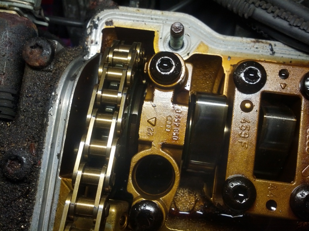

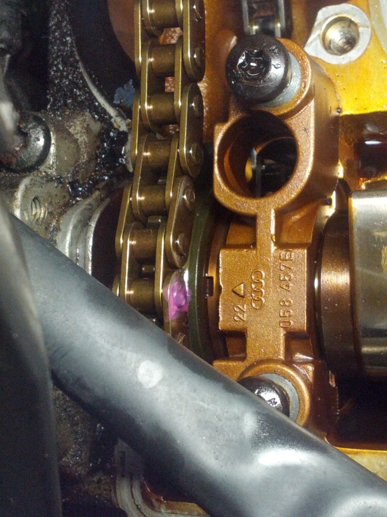

When I went to hook up my cam lock bar (with the TB still installed), I noticed that the cam sprockets didn't quite line up properly. they did not sit perfectly in line. I had to attach the passenger cam sprocket first, then press down on the lock bar to "hook it up" to the driver side cam sprocket. (it sat a few inches above the driver-side sprocket)
doing this also turned the crank a little (off tdc?)
Pics...
This is the cam on the driver side. perfect.

This is the exhaust cam on the passenger side. the camera angle may not show it but, it's a little off

When I turned to passenger side cam to meat up with the driver side (cam lock bar) It pulled the crank off tdc...

With the belt still installed, index the crank at its mark. Check the other marks to see which cam is lined up. Once you know which one needs to be moved, remove the belt and SLOWLY AND CAREFULLY align the cam that's off, using the notches and arrows in the head. Then bolt the bar on and continue the job. The crank alignment is the key point to use as a reference for the cams so once it's positioned properly, you can set up the cams to match. If its still off a hair, you can adjust with the bar in place, but if it's off by less than half a tooth you don't really need to sweat it.

sweet. I've got my two exhaust cams lined up perfectly (via cam keyway/arrow) with the crank.
for whatever reason, lining up the cams by installing the cam lock bar actually throws timing off slightly. Not sure why. Regardless, I'll trust the keyways/arrows on the cam bearing caps before i trust the cam lock bar.
I cranked the motor over by hand and all is well. timing is perfect on every rotation.
