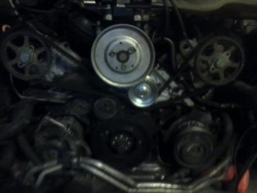

so I found an open wire, two cables 1 hot and 1 gnd, witch I cant find where it should go. this comes out from the cables from the ecm/ecu located near the fire wall in the driver side, I hope it has something to do with the car not giving any spark, I checked the crank and cam sensors and they seem to be OK... well any help is appreciated

Is there an Engine Light? Pull the codes, if you no have code reader, 10 bucks on ebay will get you a 3rd party. Download VCDS lite from ross tech, and scan.
