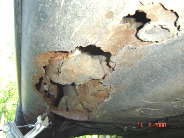

Yours is sounding like mine did except I had no other lights on. Just had 4th gear and reverse. On the instrument cluster the gear indicator was blank. I checked out all the fuses and wiring but nothing wrong there. I pulled the front passenger side seat and removed the kick panel and pulled back the carpeting to find the foam soaked and dripping wet. This has been leaking so bad and long that the floor boards are rusted out on that side. I am pissed at AUDI for this mess. Anyway I got another TCU and replaced mine and the tranny is back to normal now. I took a squirt bottle and ran water down the right front sun roof drain and it wasn't plugged. But had I not had the kick panel out I wouldn't have seen the water dripping behind it. Seems 90% of the water went out the bottom of the drain but 10% dripped behind the kick panel and rotted out the floor. BTW the TCU in mine was inside a plastic box which kept it dry. It was just bad not wet.
Good Luck!

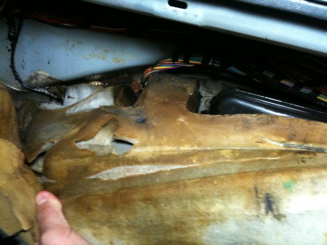

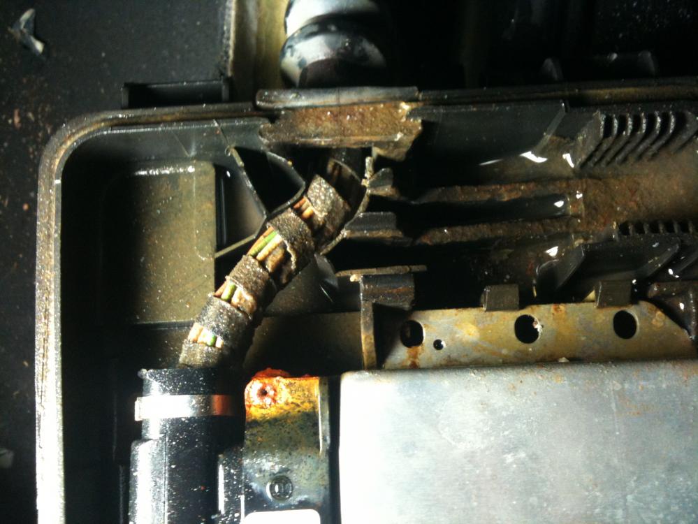

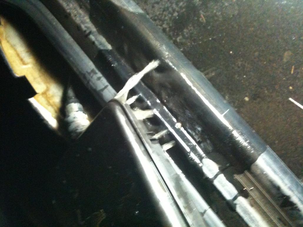

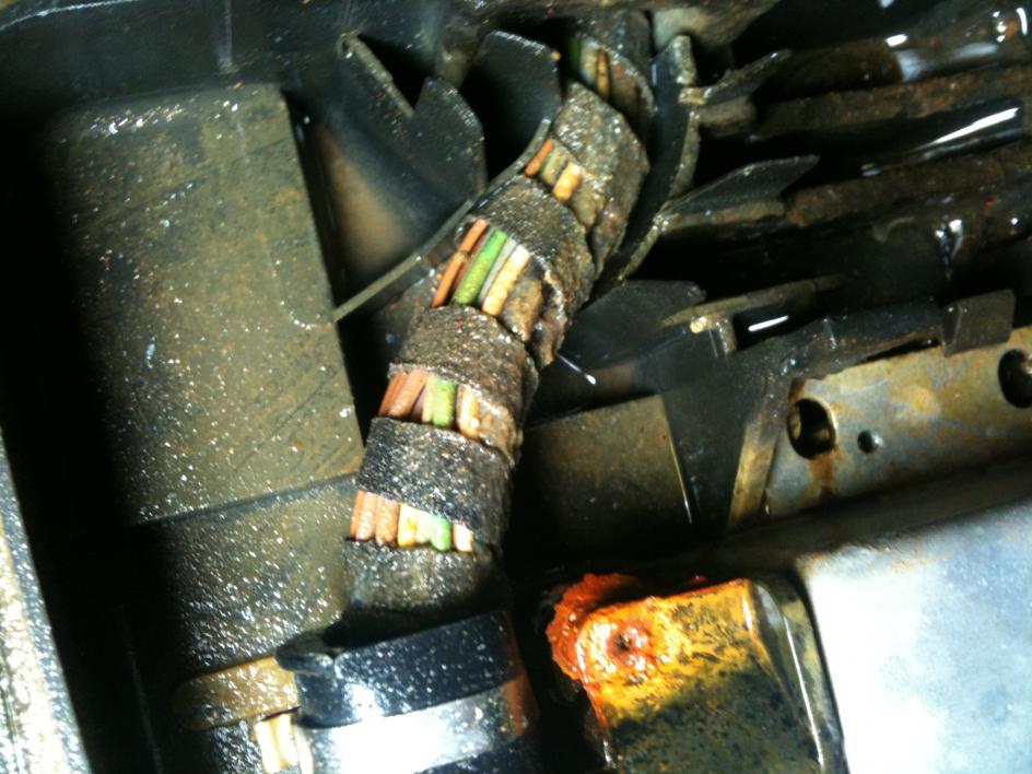

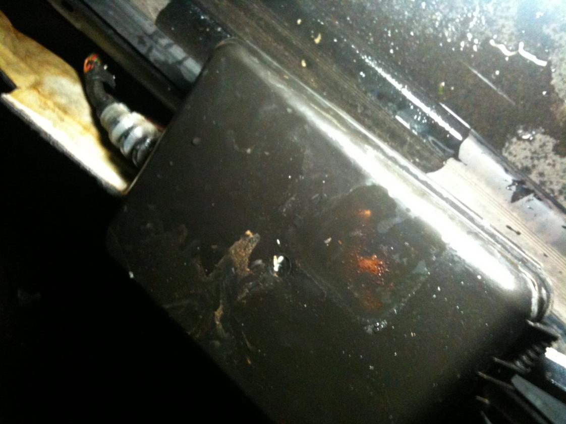

update: i took the advice us gave me and the carpet was soaked, under the carpet were the tcu was has an inch to two inchs of water. the plastic box was full off water... the plastic box on the inside actually has mold in it... here are the pics. im planning on pulling the seats out and the carpet try to dry it and get rid of all the water out of there. and there was allloooottt of water under the battery, the plug was clogged. i really apricate the help. ill update once i get a tcu..\
