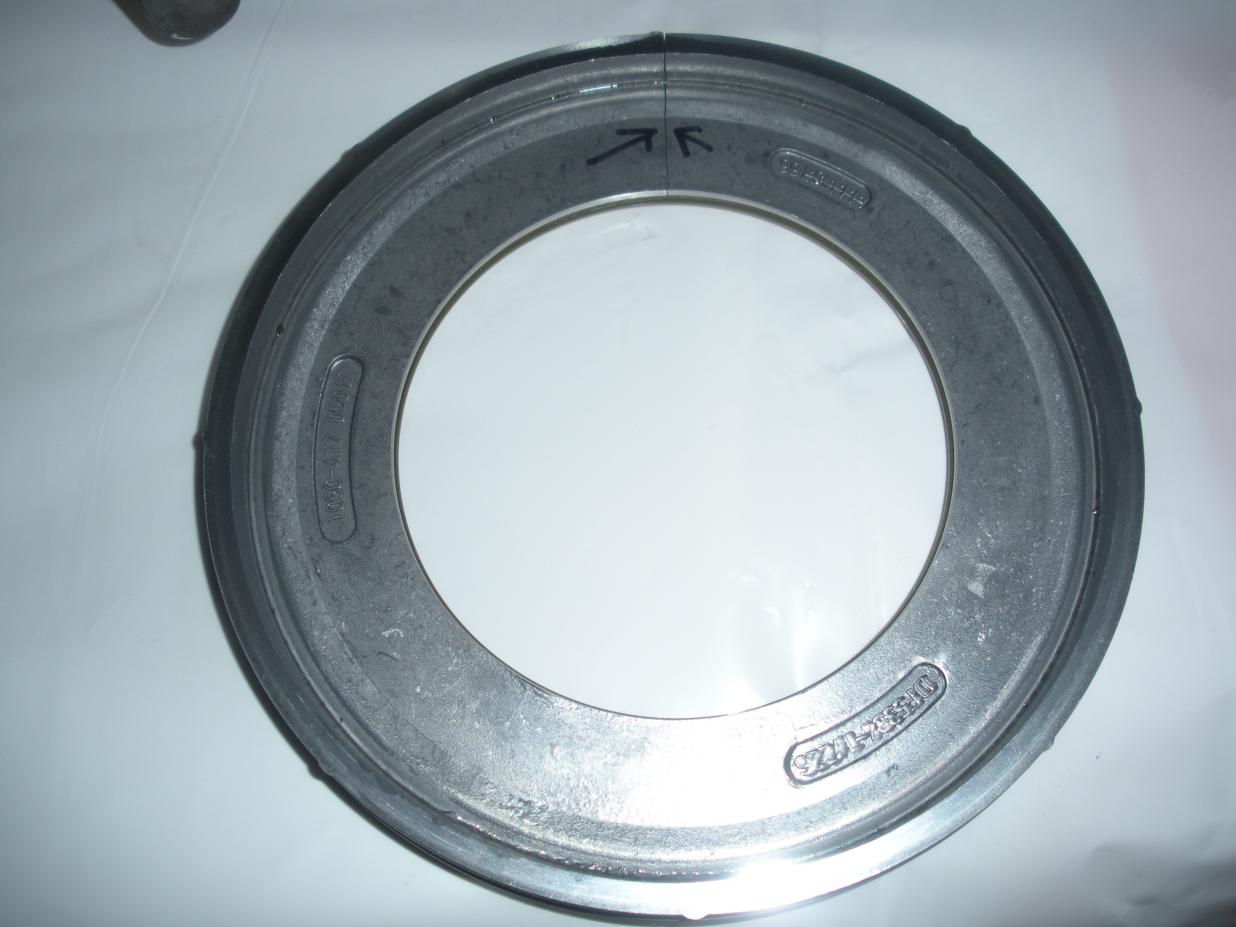

I had a small set back, as you can see in the picture the reverse gear piston was cracked. I ordered one from ebay should be here friday.
Most of the transmission is rebuilt pictures to come.

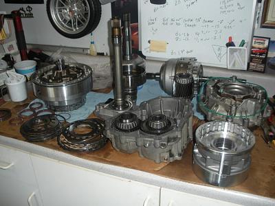

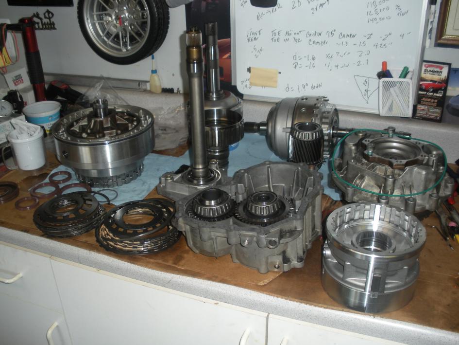

here some pictures of the parts that are rebuilt waiting to go back in the transmission case.

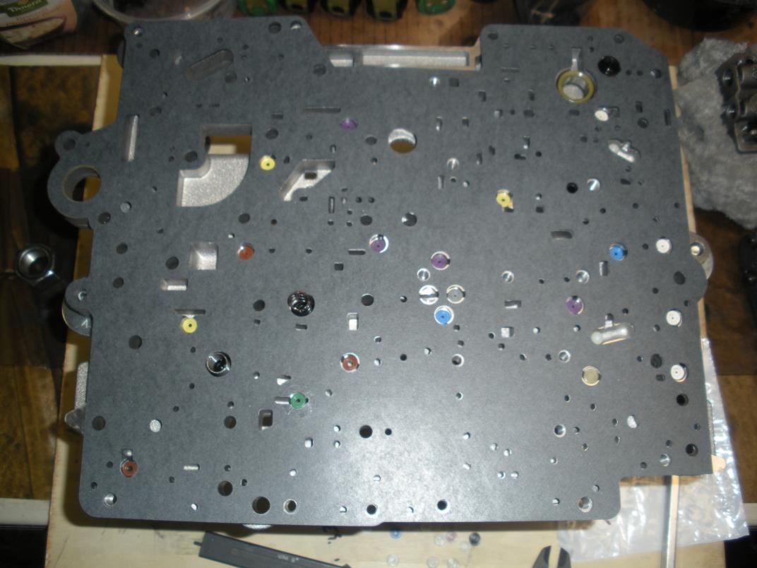

Here is a picture of the valve body in the process or rebuilding it.

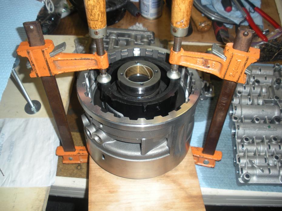

The new reverse gear piston came today. I rebuilt the drum and all the parts will go in the transmission housing today.
The tool in the picture is the only special tool I used in the rebuild, this is to compress the spring cups. There are around 6 spring cups that must be removed to get to some o'rings that need to be replaced.
