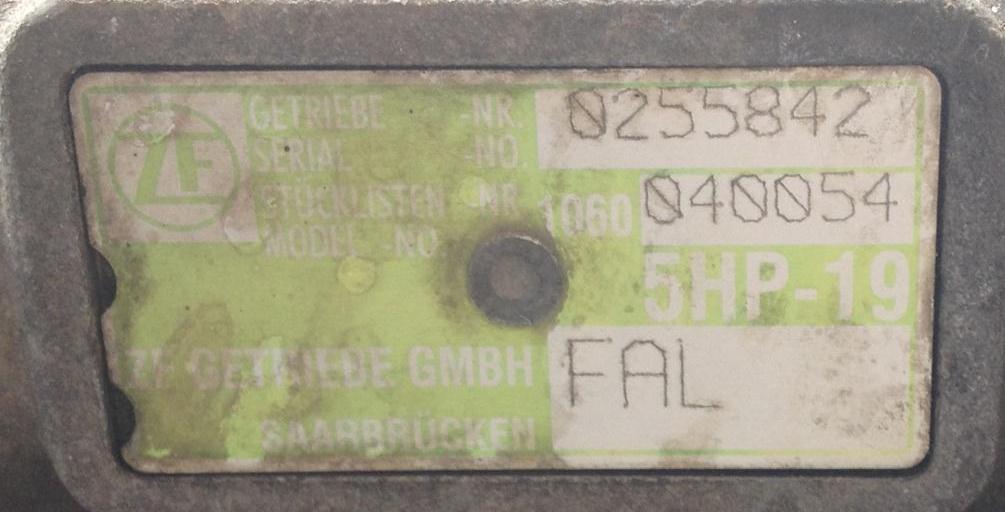

My transmission code is "FAL"
Can any code put into any of the cars above (via VAGcom softcoding)?
I know the gearing for example of an S4 is different from an Allroad, so they are likely not interchangeable.
What years/models does my "FAL" transmission fit?
Are transmission control modules all the same/interchangeable?

that code is from my ZF trans chart - the oem code is FAL but the type is a 5HP19FLA
so since you're asking only about the FAL code as many vehicle use the 5hp19 trans but have different codes.
4/00-6/05 audi a4 1.8t awd

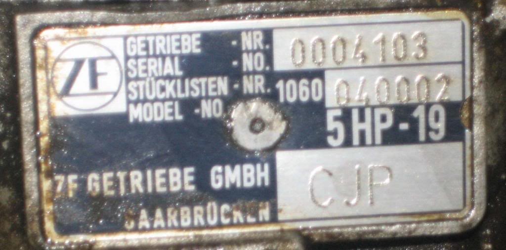

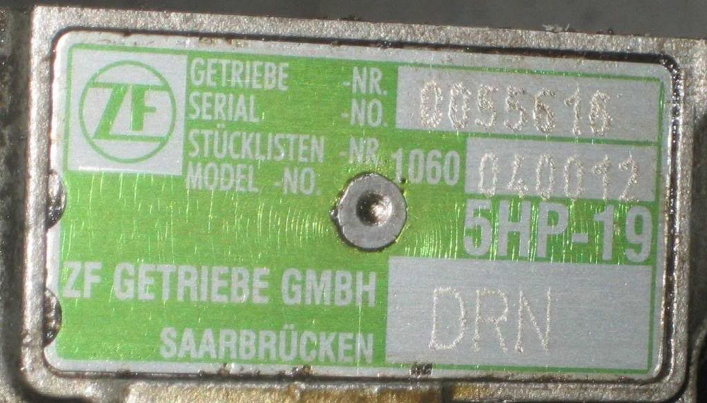

The 3 letter code is important, I think.
Here are 2 more trannies I used in a 2.8 A4 quattro.
Transmission modules may not match, internal gearing may not match (may require changing rear diff on quattros).
