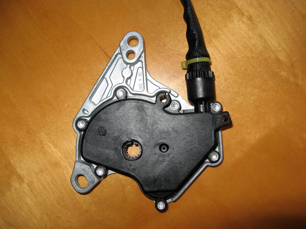

Default If you look at the switch mounting holes
You will see one that is an elongated or slotted mounting hole. This allows the switch to move so that you can make the final adjustment.
The adjustment consist of just moving the switch so that the engine will only start in P or N. Just have someone start the car in P, and then have them start the car in N. Adjust the switch so the car only starts in those two position.
