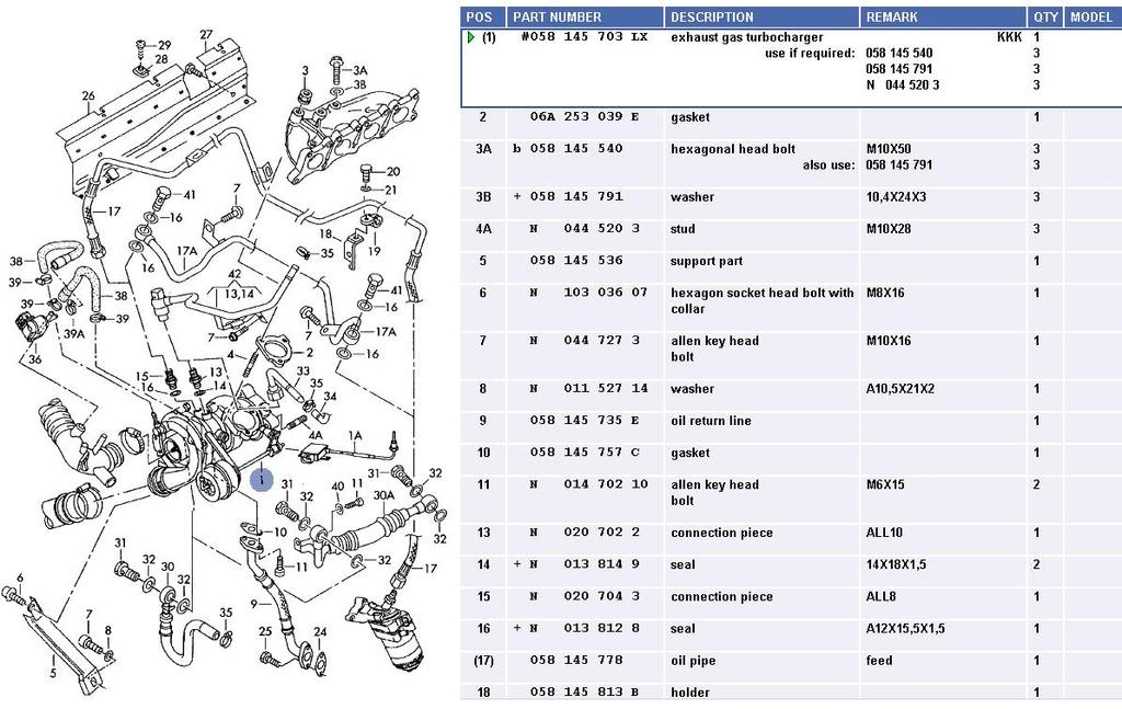

actually I did reuse the oil return lines. but I did clean them out and there was no oil restriction in them. And actually the origional turbo was not in bad shape exept for the exhaust piece inside of the turbo houseing was blown off!(the lil flap inside that connects to the pressure valve. but I started tearring everinthing down, and when I was under the car I looked at the diverter valve,(?blow off valve) and it has a long hose connected to it. now, Im not sure if it was connected to anything cause theere was no clamp around it. now could that be the cause of the problem? also where does that connect to. What I am basically doing is, taking everything back apart and cecking everything as I put it back together. would anyone know if there is a blow up illistration for the turbo hoses and such? my book does not have one. Im doing all the work I can myself cause was almost take to the cleaners by the Stealership. tried to charge me thousands to fix, and didnt even take care of the problem I broght it in for.
