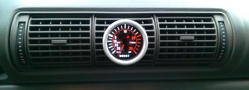

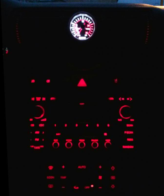

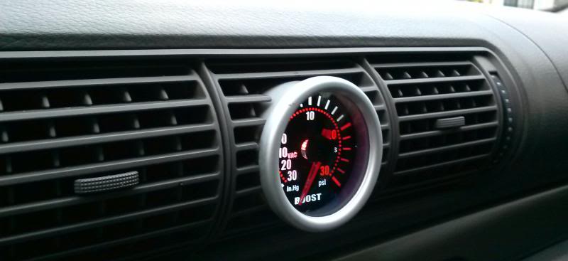

One thing Audi didn't do (and I can't think of a reason why they wouldn't have) is include a boost gauge. If I were you, that would be my first investment. That way you will always know if you're making boost and how much. You'll also have the benefit of knowing if your vacuum is where it needs to be.
I have an analog gauge and that's all I'll ever trust, but a lot of guys run digital gauges too. I simply prefer knowing that my gauge dial is tapped directly into the boost/vacuum. I don't trust digital, but some guys swear by them, so it's a personal preference, but you definitely need that first.
Here's my setup:

Let me know if I can help further.
G/L and Welcome.
