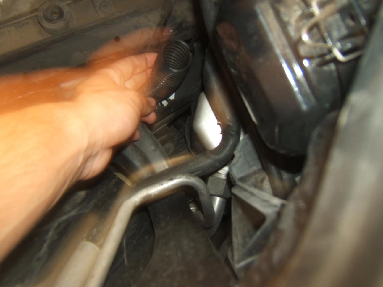

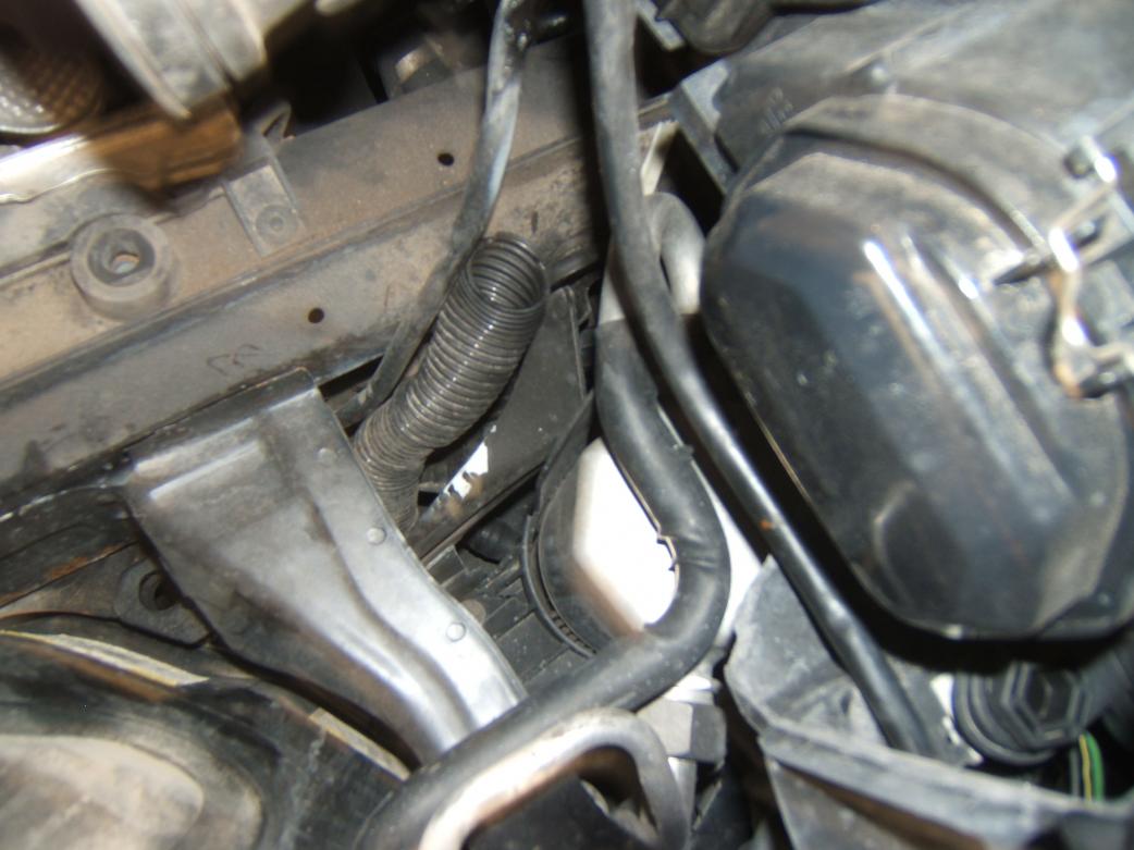

Today ive been doing some little stuff with my car changing the oil and spark plugs then i gave the air filter a good cleaning. While waiting for the air filter to dry i figured id take off the rest of the air box because i have a CEL for my SAI and heard it might just be because of a cracked hose or something. Well after i took off my air box i see this ribbed plastic tube that is just sitting there one end is connected to something and the other end is just right there. Can anyone tell me what it is or goes to. Heres a pic i took of it.

that's the intake tube for the SAI. it's supposed to connect to the airbox

if you have the stock intake box, that's supposed to take filtered air from the box. i have the evoms intake kit which came with a tiny filter to stick on that line

yeah after taking a closer look thats what i figured it was for and while trying to connect it to my air box it pulled right out of where it was connected . I figure its not too big of a deal is it, I might get around to fixing it soonish depending on work and school.

If you get crap in there it could take out your Secondary Air Pump.... Could be already since you have a CEL for it.
