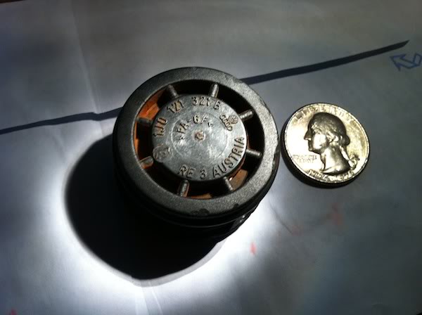

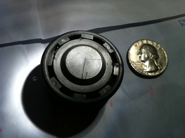

just found this resting in an empty spot in the subframe near the sway bar..
top? you can push down on it, there's a spring
bottom?
bottom?

so i searched the part number on the black rubber piece. seems as though its the bulk of the cap for the coolant expansion tank.
http://www.ecstuning.com/Search/1JO121321B/ES1692/
the black part of the cap looks exactly like the part you have just without the top part. i may be wrong but the part number seems to point to it. don't know why that would be in or around ur suspension though.
