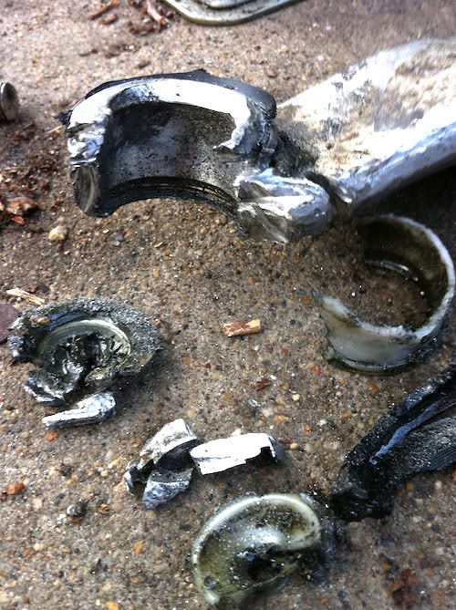

little bit of an update..
it got no easier with the rear lower control arm and in some respects was more difficult due to the position of the ball joint. it was removed with the same method as the first - cutting it off with a dremel until the bolt+ball is exposed:
all that was left was the bolt+ball stuck in the steering knuckle. here i used PB (honestly not sure if it even does anything), hammering, prying, more hammering and even let it sit overnight. didn't get easier the next day with the large ball joint removal tool i rented from checkers which couldn't even fit in the space i was dealing with. grinding at the edges of the bolt might have helped but, just like the first, it all lead up that final hammer tap and the ****** finally shot out. i then threw it at the nearest brick wall while shouting NC-17 phrases.
getting the bolt out on the sub frame wasn't easy, either, as there wasn't enough room for the long bolt to come out clean. i had to hammer it out and down at an angle while it scraped the underbody near ABS lines. it was the same getting the new bolt in.
all i can remember from the reinstallation process is that, while it was nowhere near as difficult to remove the arms, it didn't go as smooth as i thought it would.
5 days later with the arms finally changed on the drivers side alone i can let you know, quite confidently, that if your suspension is as fucked as mine was you will have a hell of a time doing this by yourself or with an assistant.
