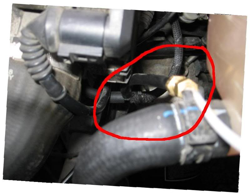

i didn't even have to boost test mine......... i looked at the hose i thought was it...... when i did my boost guage i t'ed into a hose and it was junk so kept part...... it frayed some and i replaced it, but it was actually the rubber hose that my boost hose was run into.... so i replaced it
it would shrink when cold and expand when warm/hot...... that cracked it
here is a pic of hose i was talking about, circled

the rubber hose attached to the brass fitting was 8 months to a year...... it is supposed to be pliable rubber, but was actually hard
