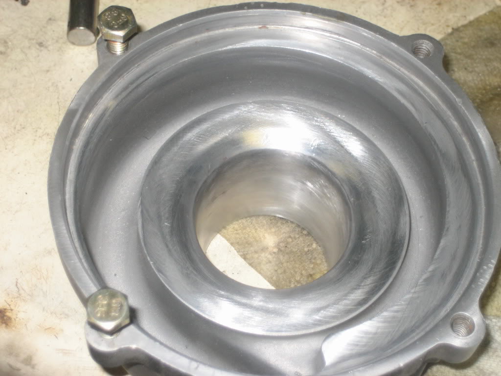

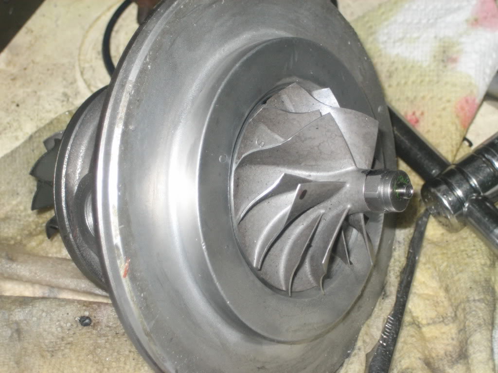

Here are the data for my custom turbo:

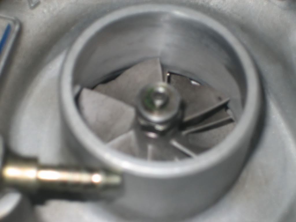

COMPRESSOR WHEEL
Inducer: 41.0 mm
Exducer: 54.0 mm
Tip height: 5.6 mm
Blades: 6 double,staged, extended tip
TURBINE WHEEL
Inducer: 44.5 mm
Exducer: 40.44 mm
Blades: 12
10 degree clip

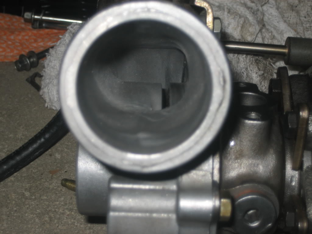

Compressor housing shape-matched to larger compressor wheel and blade shape.
Compressor outlet flow optimized.

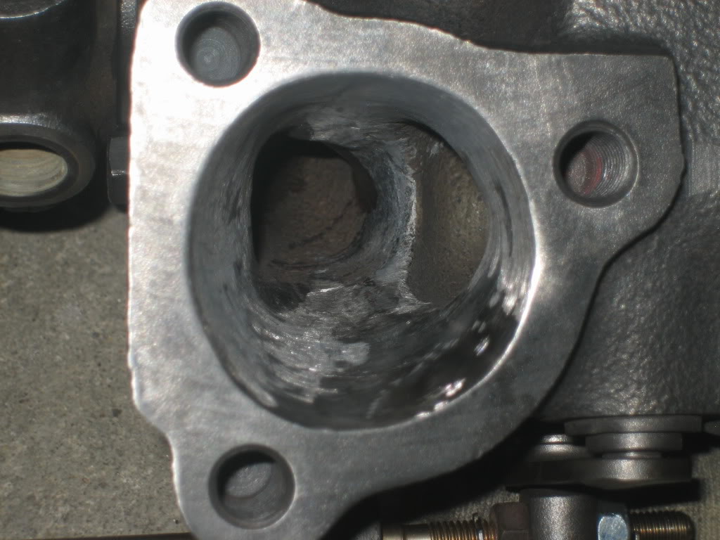

Turbine inlet flow optimized.
Calibrated waste gate actuator.

In and running since a while. Great midrange and not jumpy under 2500 rpm, but no high RPM screamer either (see boost curve).

Total cost for the custom turbo including all material and consumables way under $1,000 (I think the turbo was $800 using housing, etc. from my K03, but all new wear parts, actuator, waste gate flap, cartridge, etc.)
