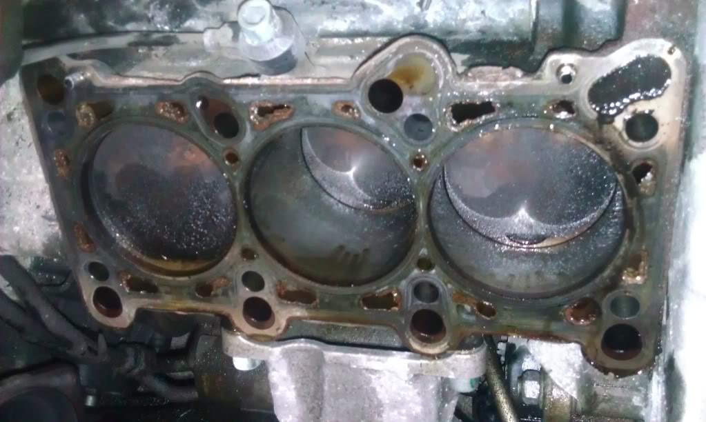

Okay I got a broke valve stem and a bent one as of now. All the pistons on the driver side show some damage from the valve stems. Should I replace all the valve stems on this side and leave the ones on the passenger side alone since they look fine? The pistons are not cracked but the tops of them are damaged from the valve stems should I smooth the surface of the pistons?

If you can be certain that some are ok, leave them, but I'd probably do them all just to be safe. You should smooth the pistons if possible - ridges can become hotspots that lead to detonation. As to the face where the tensioner mounted, smooth and clean it so the new one spins freely.

for the price of internals and the amount of work, it'd be cheaper just to get another motor

Either that or new heads, thats what I did since I already trusted my bottom end

i think i am going to just do the ones that are damaged and i got lucky that only the driver side went out of timing the passenger side is in great shape. i know for sure that i will have to replace two valves but at the worst maybe 5 so i am just going to rebuild this head and hope for the best.
