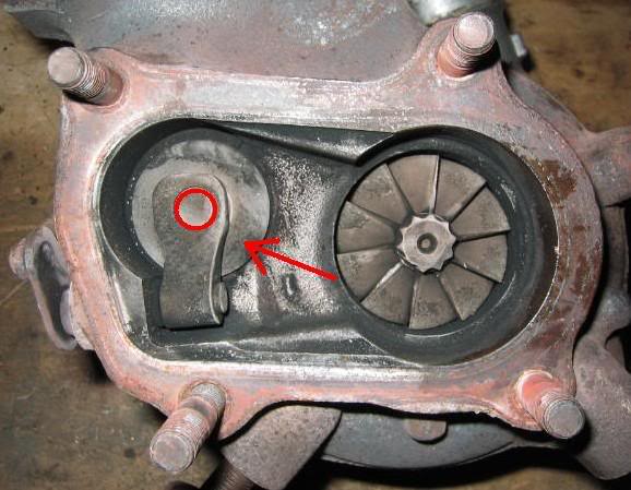

no it would just make it much MUCH harder for the air to flow. the turbo isnt a sealed pump where if its not working nothing would get past. exhaust would still flow over the non spinning wheel, and air would still be sucked in past the compressor wheel, but it would put a HUGE damper on airflow.
it could have also been the wg arm inside the turbo broke. like here... (no thats not a k03, but they sometimes break around where i drew the red circle.)
