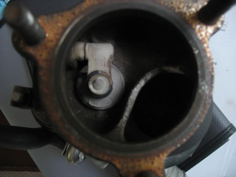

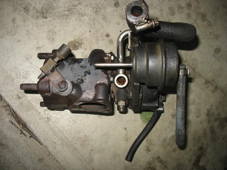

I had a chance to get a better look. Got the turbo out and saw this:

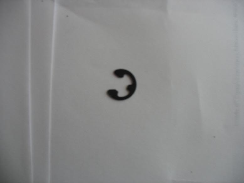

So the arm snapped, and the reason for that I belive is because the wastegate flapper inside was binding when trying to close causing stress on the arm. I don't know if there is supposed to be a clip or bushing where the flapper mounts to the arm, but there was a lot of play in it and the reason for binding. So I too the turbo to a semi/freight repair garage and the guy welded the arm on and gave me a C clip for free

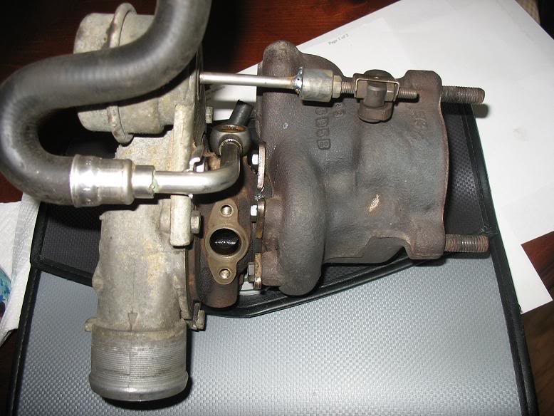

You can see where the C clip is installed here:
Now the wastegate opens and shuts smoothly without binding.
I don't know how long this turbo has been out of commision, but I'd say it's been a long time because there is virtually no shaft play, it spins freely, and the blades are in near perfect shape. None are chewed up. Can't wait to get this sob in. Hopefuly the weld will hold up.

Thats a new one. Dont think i have seen a actuator rod snap before. Still cant believe how many bad A4 wastegates there are. You just about never see one on a transverse turbo. If the weld for some reason doesnt hold, im sure there are people with blown turbos that would sell you the wastegate.

Yeah... I'm wondering if there is anything I can do to insure that weld before I put the turbo back in.

Eh not a new one it was a common problem for this year...
oh yah by the way Told you so... lol sorry my egos to big not to point out when im right...
dont forget to check you oil lines make sure theres no build up of crud.
I cant vouch for the weld (pretty ugly) but it should be stronger than the stock peice if its solid

Just try breaking it with your hands. If you can apply a decent amount of pressure w/o it breaking or bending, you should be fine. That weld looks plenty strong for what its doing unless there is no penetration that i cant see
