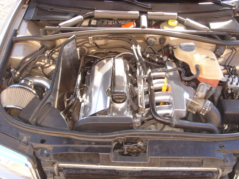

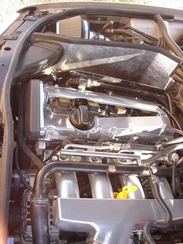

AEM, HKS, K&N or a Blitz are some good filters. You just need to find one with the right size inlet and that is short enough to fit in the space you have.
If you are mounting it right to the maf DO NOT get a filter that has a inverted cone because it will cause a dead spot right in front of the maf sensor and give you incorrect maf readings.
Pics of Fred2kA4 setup with the Blitz filter.
