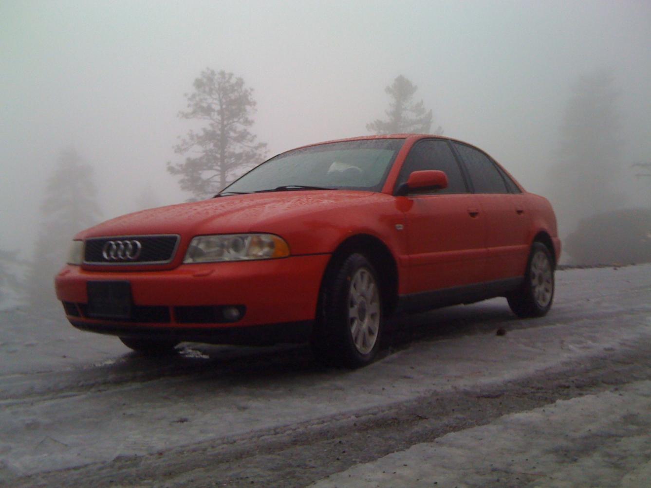

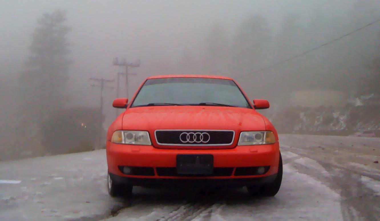

The tubing and check valves should fix all the minor boost line leaks and the new turbo hoses should add some gain. I chose a color other than black for everything to make it easier to spot oil leaks, black oil on red will stand out more than black on black. My B5 happens to be red so I figured why not go with red.
