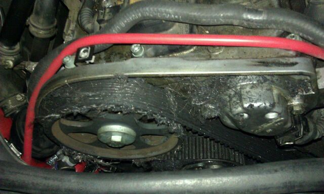

some shity news... Did the timing belt and cam chain tensioner and all the other stuff i needed to change. Car started fine and i let it run for about 10 mins before going home. while waiting at a light, clutch in and foot off the gas, car turned off. opened the timing belt cover completely worn down on the backside of the belt... the non-toothed side. got a code for implausible camshaft position sensor so it's safe to assume the belt broke.
so I've got a couple questions on how I should proceed:
I need to open everything again to see for sure, but is it possible to put the idler roller or the tensioner roller on too tight to where they don't spin causing friction on the backside of the belt?
Since the engine was at idle when it shutoff/belt broke, is it possible that the valves aren't damaged? What if i line up the cam sprocket timing mark with the valve cover and turn the crank to line up with the timing marks I made on it, setting top and bottom to tdc and put on a new belt and start it up... what could happen?

Update: Talked to my friend who's an audi tech, said most likely something fell in the bottom cover and ripped the back of the belt. Also said since it was at idle when it happened I might have gotten lucky and not bent any valves. easiest way to check is to set it all to tdc, install a new timing belt and turn it over.
starting today, will post updates tonight

Yikes! Good luck man. Wonder what made the belt fray like that?

Im betting it's something that fell into the bottom tb cover, got jammed between the crank/belt and the bottom cover. Or the idler and/or tensioner roller failed. Fingers crossed, I have everything opened up again except the bottom cover. Ran out of time today so tomorrow I'll continue and post an update

what up everyone, opened the lower tb cover... nothing was jammed anywhere, I thought I would find a bolt or something like that.
removed the belt, shredded, and took out the tensioner roller. This is the one that's bolted to the head right above the tensioner. It was defective. seized, stopped rolling and started melting through the belt as it was running. Ill post pictures shortly.
I've contacted Blauparts about it and they're having me start the 'corporate paperwork' to start a claim or report or whatever. The lady was nice and was pretty cool so I'll go along with what they say and hope they're going to be willing to help out if there is valve damage.
they said they'd most likely send out replacement parts for what failed and what became damaged as a result, namely the tensioner roller, timing belt, tensioner and idler roller. So, I'll put them on and do compression tests when I get the parts. for now im just waiting and hoping I got lucky and it'll be cool.
