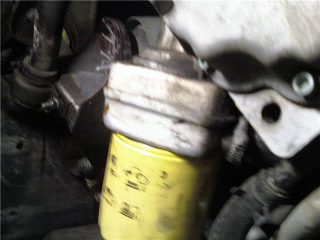

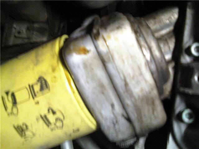

ive got oil leaking from the white square object in the pictures below
it may be something simple i should know what it is but i leak about a quart of oil inbetween oil changes because of it
any help is appriciated

Hmmm, didnt know 2.8's have an oil cooler. Looks like thats what it is.

what would i have to do since it is leaking oil not next to the filter but above it?

The seal is leaking where the cooler meets the engine block, I guess. Drain your oil, remove the filter, remove the coolant lines (pinch), remove the center nut (above the threads where the filter screws on) and it should just pull/twist out. Probably a good idea to replace the cooler too. Eventually the insides will deteriorate and cause an internal coolant/oil leak anyway.

they are pretty cheap if you install it yourself, i believe ecs sells them for either 80 or 120 bucks, i cant remember which. if you can change your oil yourself you can change the oil cooler. if you dont want to replace the whole thing, you can just replace the o-ring that seals the cooler to the block. probably under $3 from a dealer.

I own a 2.8 too... had the same leak and the dealer wouldn't schedule an oil change unless i get it fixed first.. So went to my local mechanic and he found out that there is an O-ring inside the oil cooler that is causing the leak.. Its an easy fix and part is pretty cheap tooo....
Try replacing the ring before buying the cooler itself....Well this is my experience and YMMV.
