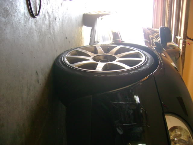

I have 18x8.5" wheels on my car right now...
originally i had 235/40/18 tires, but wen I went with race springs (2 inch drop), I had a rubbing issue only when bottoming out(which was remedies by rolling my fenders)
but now I have 225/40/18, and rolled fenders and I don't have to worry about a thing with my 2" drop
these are my 235/40s...my 225's are stretched and not as tall
