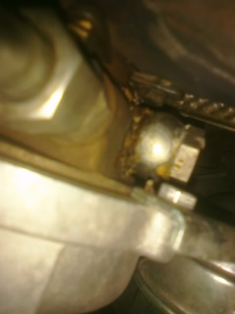

Couldn't tell you what that bolt is or whats around it, but I wouldn't be too concerned with it personally.

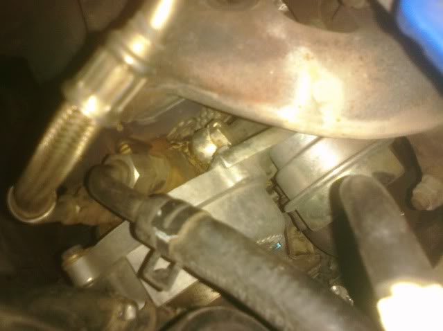

History: Prior to me buying this 1999 audi A4 1.8TQ in June, the last owner replaced the stock turbo with a K04 after the original blew. The car currently has an APR tune on it and should be from what I understand peaking boost around 14.5 - 17 lbs. Well long story short it's only peaking at 4 - 5 lbs. right now and I'm assuming it has a pretty significant boost leak. I noticed this bolt in the turbo and it has some crystalized...stuff around it, any idea what it could be and what this orifice in the turbo is for?

Also if anyones got an extra one of these hoses let me know, I need one! Mine is getting a nice slice forming on it from the fan housing that is about halfway through the hose now.

If the opening in that hose is large enough I could see it being the cause of your problems. That is the hose that goes from the turbo inlet to DV correct?
