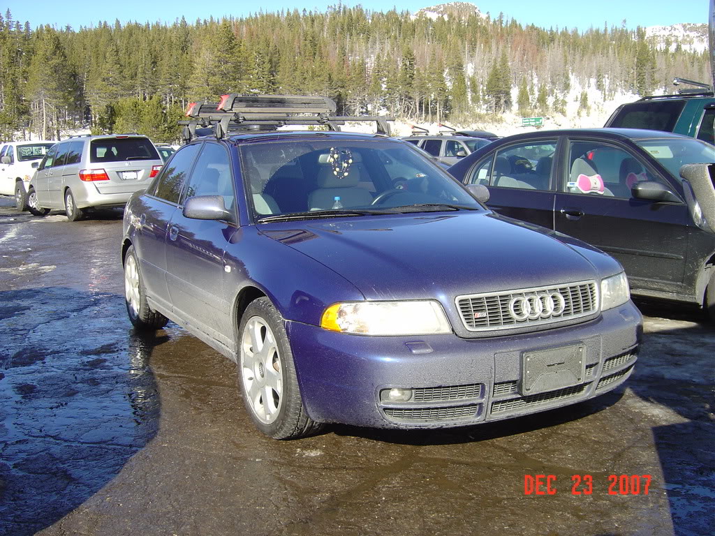

If you want to eliminate wheel gap, the S4 suspension wouldn't do a good job with that.
Have you considered the cheap coilovers route such as V-Maxx or ST's?
