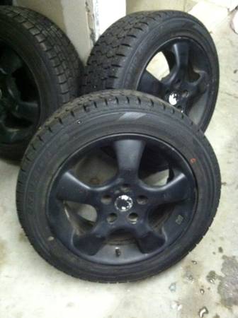

Hey guys, new to the forum. Did a search but couldn't find an answer to my specific question. I'm looking for a set of snow tires for my daughter's '01 A4 Quattro. Found a set on CL for a good price. The owner claims he just bought them for his Beetle and they don't fit. His dealer told him they are from an '06 Jetta. If they really are from a Jetta, will they fit the A4? The bolt pattern is correct (5x112).
The other issue is that I can't find any Jetta wheels that look like these. Do these look familiar to anyone? Thanks!

Regardless of the vehicle they came from, the bolt pattern and offset are what will determine if they fit your daughter's car.
If the offset is wrong, body/suspension/brake interference and bearing wear may be the result.
