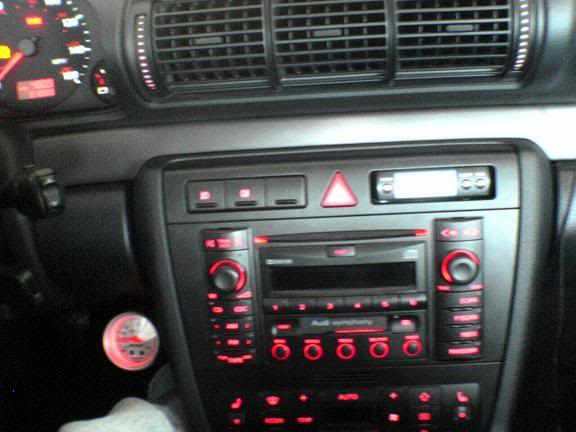

I removed my cupholder to put my turbo timer in there so I just ran the wires from the light that was in the cupholder and connected them to the boost guage so the light comes on when you turn your lights on.

Just tap into the ground and + in the dash, and hoop up the + to the red and the ground to the ground, that should work, if it doesnt, connect the remote(on/off) to the + too. Its a little rigged but it should work.
