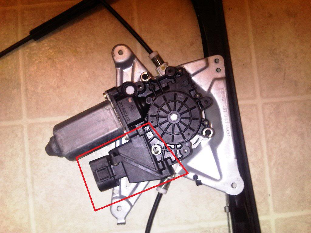

ok i got my driver side regulator replaced... HOORAY!!... or not... i have been stumped... here is a pic of the original.. notice the red box... thats where they window controls and **** connect to make the window go up and down

now here is the new one installed... but there is no connection port anywhere to have control of the windows.... any idea wtf to do? this is pimax window regulators... they both came wiht the motor

Old Oct 6, 2009 | 01:02 AM
  #18
auditech79's Avatar
Site Moderator
Joined: Feb 2007
Posts: 9,004
From: Nor Cal
Send that POS back and get the correct one from the dealer that doesn't come with a chinese motor attached to it.

do u have 400 dollars? i dont.. so this is what i have to work with.. i need help not insults

From: Nor Cal
The regulator is $150, not $400. You can't use that regulator unless you want to hard wire it from the looks of it.
