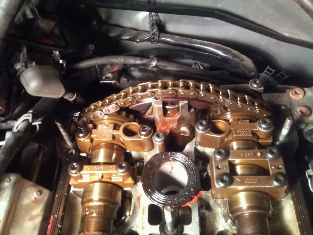

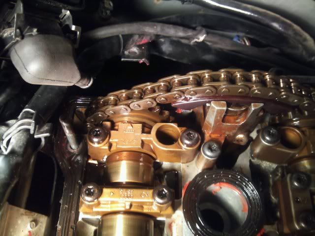

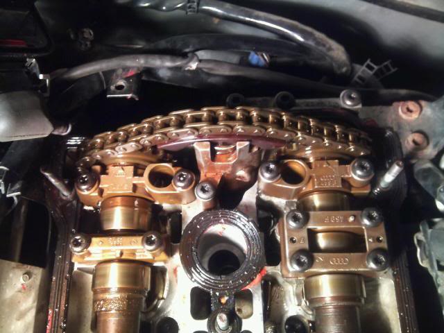

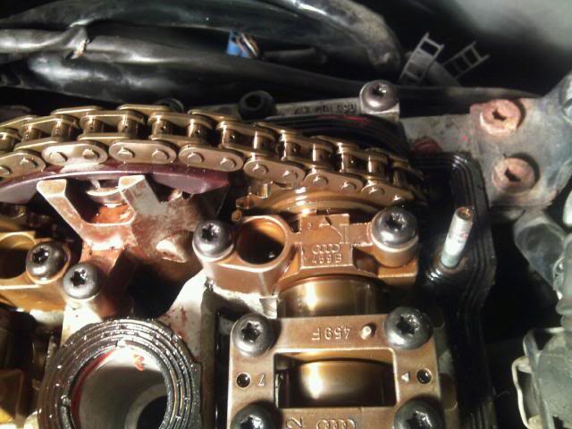

Ok Im currently letting the spark plug wells dry out over night to try and get the gas out. Well I have a feeling its still not going to start and the more I look at it still think my timing is off. I want you guys to take another look before I pull the head off. This is what the cams look like after cranking it about 10 times or so for about 3-5 seconds at a time. I feel like the intake cam should be another tooth over to the right.There are without a doubt 16 links in between the cams where they sit now..You should be able to count them from the pictures. But what do you guys think? Keep in mind the exhaust cam is a little off to the left too.. The cams are not perfectly at TDC but very close. Im just wondering do you guys think I should move the intake cam one more tooth over to the right or just try and start it how it is now after its not flooded anymore, and pull the head if it doesn't start?

Tried starting it again this morning, hooked it up to a battery charger and now it pops and backfires numerous times when trying to crank it.. White smoke coming out of exhaust too. I guess its good its seeing some signs of life now but still no start.. Should I keep trying to just crank it for a while, or should I just give up and pull the head?
