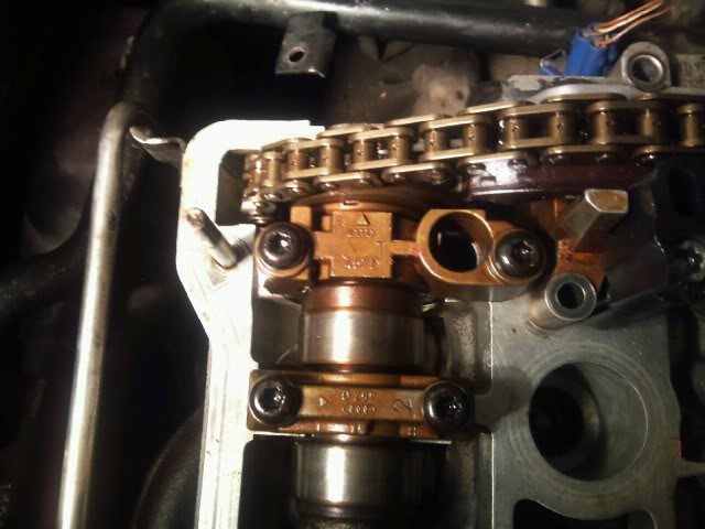

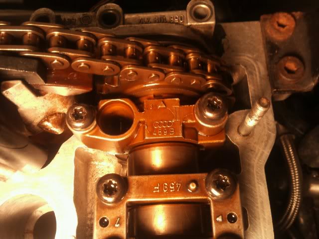

I got my head back from having the valves in the head replaced. The guy who did it for me didn't put the cams in. So I put the cams in the way they seem to sit the best. The marks on the cams were a little to the left of the arrows on the cam caps when I put the cams on after the valves were put on. I would think you should line up the cam marks to TDC so they are lined up with the arrows on the caps but the cams didn't seem to fit right when they were like that. When I rotated the head by the cam gear the marks on the cams line up perfectly with the arrows on the caps when the mark on the cam gear is lined up with the valves cover. When I rotated it by hand it had some hesitation about every half turn of the cam shaft. I like every half turn of the cam gear is would stop and then go easy for half turn then stop...Is this normal? Here are some pics of how the cams lined up right after I put them on after having the valves put in. Let me know what you think. I want to be sure before I start it so I don't **** anything up again. And ignore the broken *** cam tensioner tool in the pics.

Old May 28, 2012 | 09:21 AM
  #40
redmond1501's Avatar
Joined: Nov 2010
Posts: 390
On my 2.8 at least the resistance is pretty consistent over the course of two manual rotations of the crank. Then again, the motor had 150k on it when I did the cam seals.
