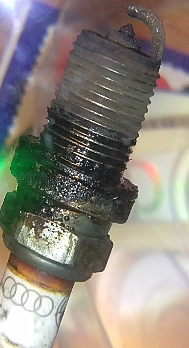

The check engine light came on as I drove home from work so I stopped at autozone , had the code read and got P0303.
I picked up a coil from them and NGK plug and changed both.
Car still would not turn over.
A few days later , after reading about autozone coils being bad quality , I returned it , thinking this was now the reason why my car is not running ,and got a new coil from the dealer. I also got more new plugs from autozone but they were 4 cheap autolites.I figured maybe all the plugs were bad.

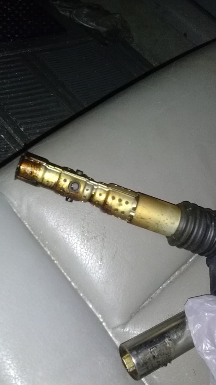

Well the coil I had originally taken out didnt look bad and after changing ALL the spark plugs , thereby taking out every coil , I found a coil that looked horrible. After seeing how bad this coil was , I thought maybe I counted the cylinders wrong in reference to the code saying "misfire P0303". So , I put the new coil I got from Audi in the 3rd spot and put back all other coils and new plugs. Car still wont start. It's sounds like it's cranking a bit though.

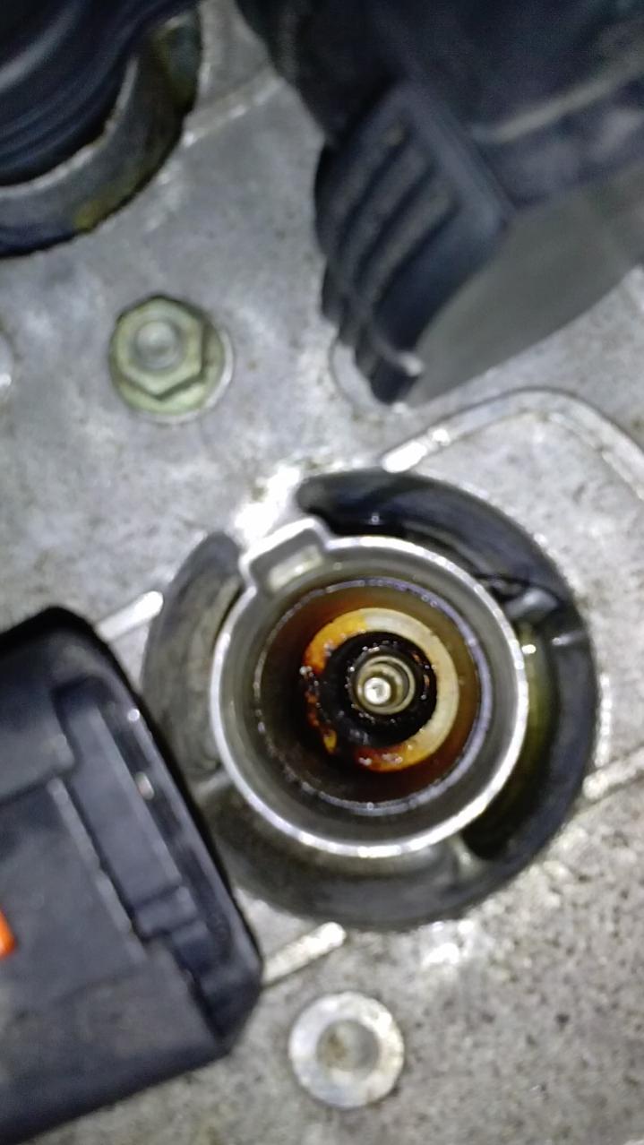

Pics are of the coil and plug from what I NOW think are cylinder 3 , although I am not sure I am counting them right. Is it 1 from the hood with 4 being at the firewall or the opposite?

If anyone has any ideas , please let me know.Pics are of the coil and plug from what I NOW think are cylinder 3 , although I am not sure I am counting them right. Is it 1 from the hood with 4 being at the firewall or the opposite?

Your car should still start even with a fouled cylinder.. from your photos it looks like your getting lot of oil in the cylinder.. there shouldn't be that much carbon on the tip and there also shouldn't be that much oil film.. there is just so many things that it could be..
have you pulled the rest of the plugs to see how they look?

The pig trails that go to the coil themselves tends to dry rot and crack and sort out. So check your ignition fuses if it's not cranking. If you pull back the rubber boots on the pig tails you should be able to tell very quickly if the wire is bad.. it also has the same problem on the two injector wires.. but looks like you coils are bad for sure.. you can ohm them out.. I just replaced them all on mine runs like a dream.
