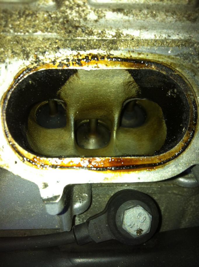

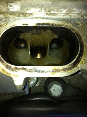

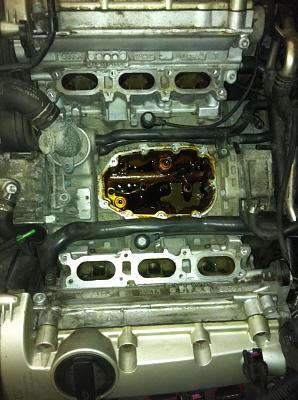

So here's the current status. I ended up pulling off the intake manifold, and after breaking a few things (crank case ventilation hose which evidently breaks all the time), I got it of and could take a look at it and the injection ports for each cylinder. They all looked fine with the exception of a piece of plastic I found in port 6...not the problem cylinder :-(. None the less it was very odd but had no idea how it got there or what it was.
After asking an audi tech from the german repair place he had told me to look at the variable length drive shaft in the intake manifold. I took it out and to my surprise it was broken. Basically, it was sheared in half from the point of contact to the outside mechanism that spins it. Now, on one hand, I'm kinda happy that I found something definitely broken because that could obviously be causing a problem and it would be coincident with the idea that it only happens at certain RPMs and under load and driving style etc (I believe that thing spins based on load conditions and other factors to give the best performance).
On the other hand, I'm a little nervous because I don't see why that would cause a problem on just cylinder 4... I have to fix this, it's clearly a problem, but will it fix the misfire? I don't know. I have pics I've posted but when the parts come in tomorrow and I get it back together (hopefully) I'll let you know what happens. I also purchased the large radiator fan and the new crank case ventilation pump/hose assembly. 470$ for the intake drive mechanism (would have been 1090$ for the whole intake manifold...a piece of plastic), 300$ for the fan, 170$ for the pump/hose. I REALLY hope this is it.
After showing the tech he didn't think there would be much likely hood of bad valves or a blown head gasket (oil looked ok), but there was water condensation in the crank case ventilation hose and I'm hoping it truly is just condensation (i heard it to be the case from multiple techs).

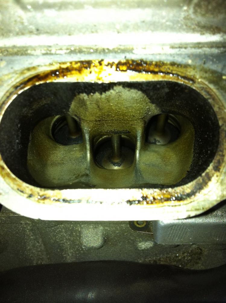

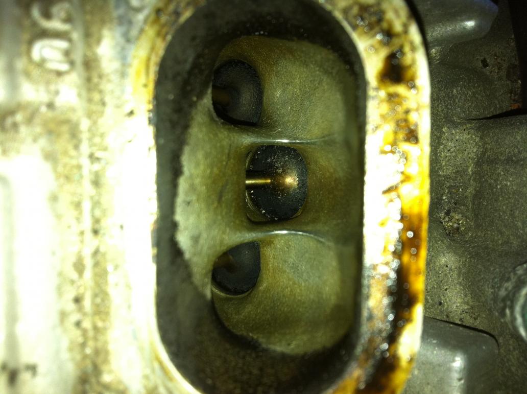

Because I can only upload 5 at a time, I'll post the rest of the pics in another post. But for this one:

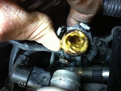

1833: Inside crankcase ventilation hose, a frothy mix of water and oil it seems...opinions?
1850: Cylinder 1
1851: Cylinder 2
1856: Cylinder 3
1857: Cylinder 4
1850: Cylinder 1
1851: Cylinder 2
1856: Cylinder 3
1857: Cylinder 4
1858: Cylinder 5
1863: Cylinder 6

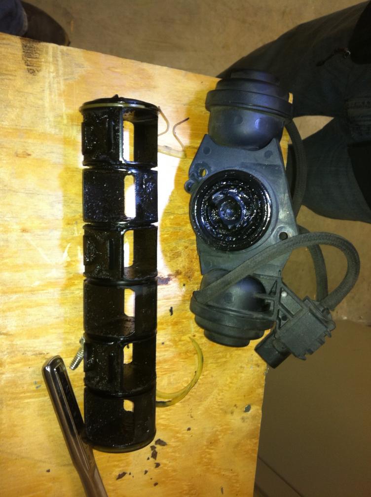

1877: The broken drive train that inserts into the front of the intake manifold. This I believe should be one unit. You can see it is missing a few rings (you can see two of them sheared off above it. And the spring that fits between the front vacuum motor and the tube has gotten all chewed up and found little bits of of the metal in the gunk inside the manifold.
1881: A little disconcerting, what looks like olive oil is water in the little compartment below the intake manifold (this was under the black cover under the manifold).
1863: Cylinder 6

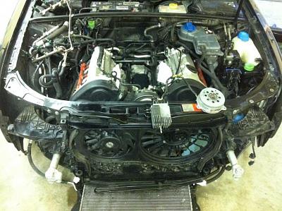

1890: The car as it sits till saturday waiting for the drive and fan. Gonna have to get a new dip stick, stupid thing is so curvy it kinks and wears all the time. Anyone know of a metal version that won't?

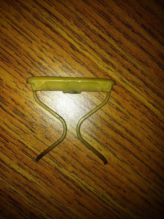

1891: This is the little piece of plastic I found just laying there, lodged in the intake port of cylinder 6 pictured in the previous post!
Let me know what you guys think...that intake drive could be the problem I'm hoping. It is clearly broken...but why cylinder 4 only. The heads seem ok, I drained the oil, no trace of coolant or murky white stuff.
If this doesn't fix it I'm at a loss. I pulled the plug on 4 and looked as best as I could inside but couldn't find any evidence of coolant or liquid. However, they head of the piston was shiny and clean while 5 and 6 had the typical burnt look from combustion...
