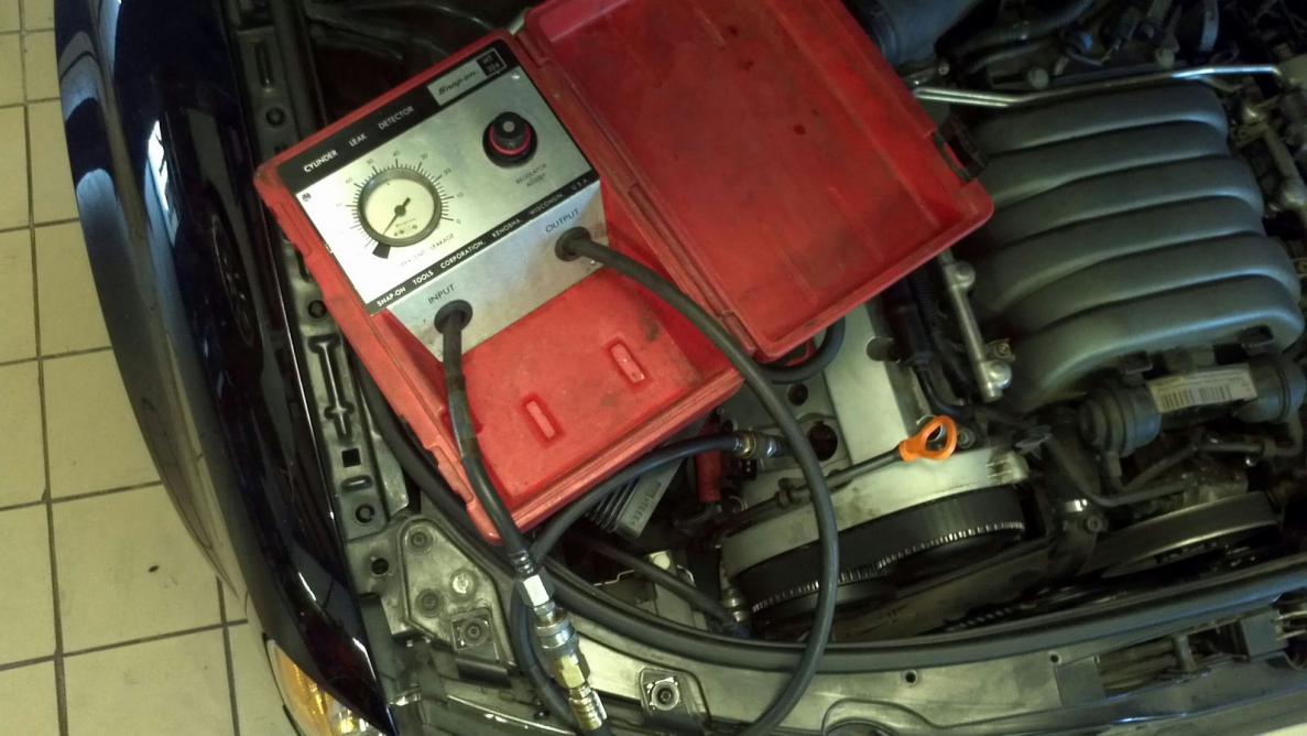

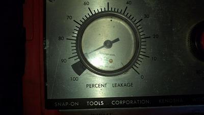

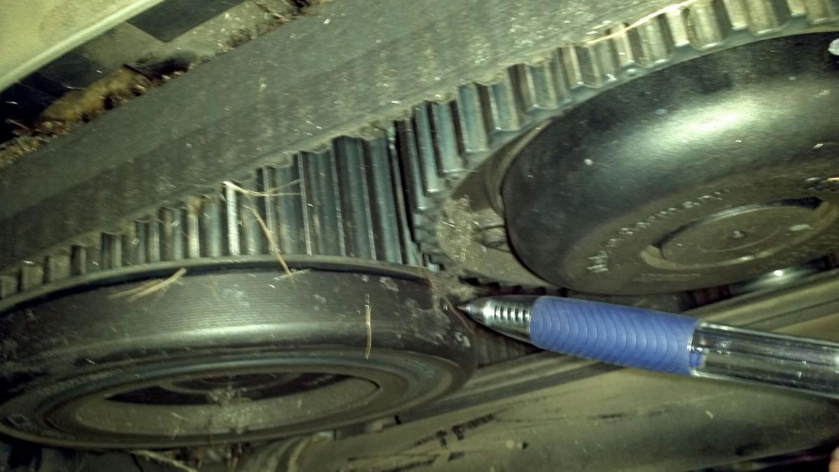

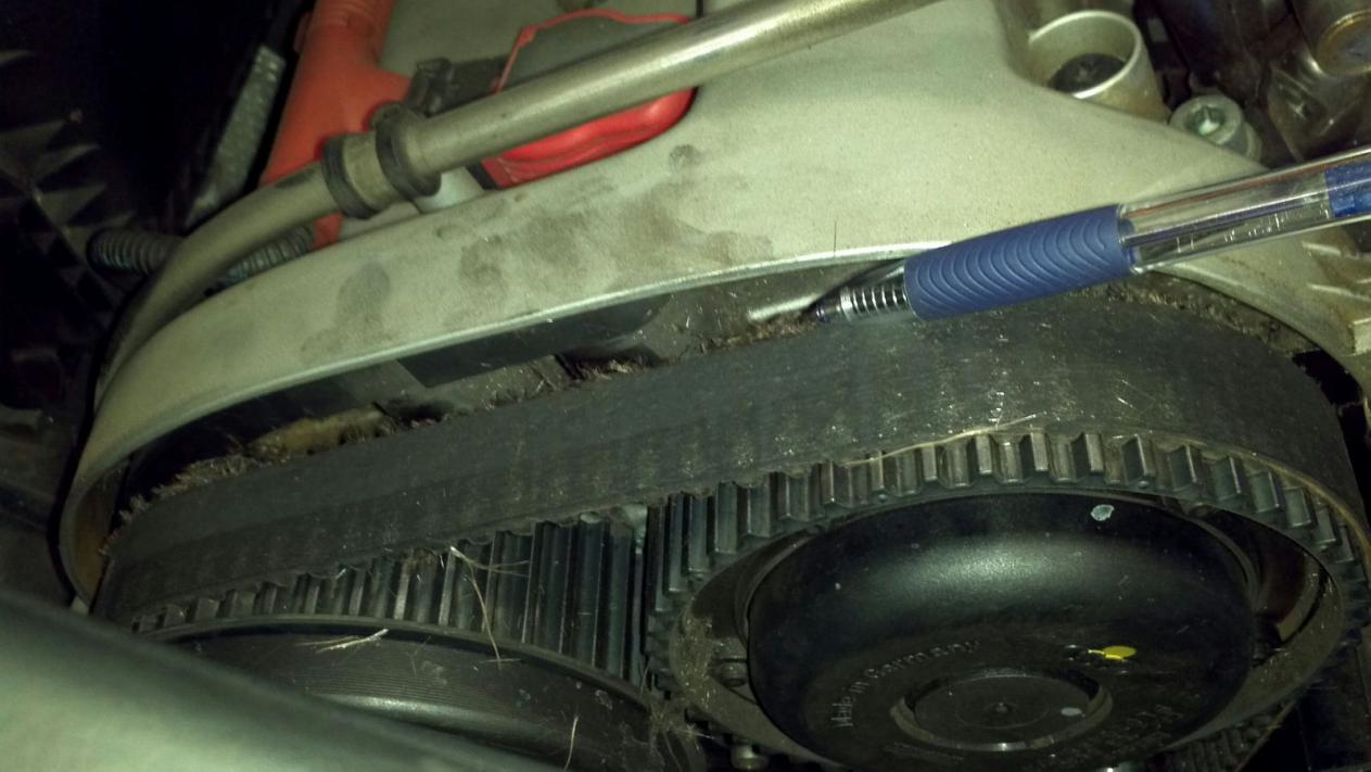

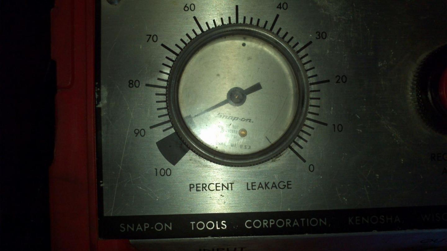

Well according to the shop the timing belt is shredded. I didn't get as much details as I would like because their busy but they said something about a pulley or cam seizing. They did a leak down test and it's likely the valves and possibly pistons are damage. I have a few picks that I will try and post later...it only has 13k on the timing belt and water pump but the shop that did it said they only do warranties up to 10k miles.

Here's the pics
