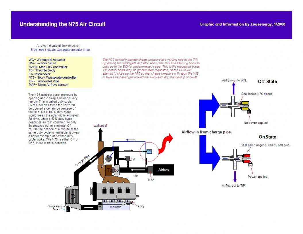

The air venting through the splitter dv is possibly due to that method of boost leak testing. That method creates positive pressure in the turbo intake pipe(TIP). The TIP, never under anyother circumstance, has positive pressure. By testing it with the method you are currently using it applies the same pressure to both sides of the valve and the intake system will never see anything like that in real life. It is pre-turbo so at that point in the system it is only vacuum pressure. I would attach the boost tester fitting to the turbo inlet and completely bypass the TIP. See what that does. I've attached a diagram that may help you to understand my theory.

That makes since. Thank You!
