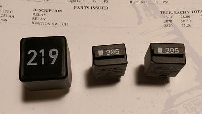

Default Exact symptoms, problem solved $650 later :-(
Exact symptoms (no crank, no start, humming around left side of dash when key held in start position) on a 2003 A4 B6. It may start randomly like 1 out of 10 tries, and it acts normal if it starts. Took it to indi Audi shop for 2 days. Final diagnostic is bad ignition switch (on the other end of the ignition key switch inside steering column), 2 bad 395 relays inside ECU box, and a bad 219 relay (think these are in the black ECU box). Almost 200 in parts and the rest labor.
