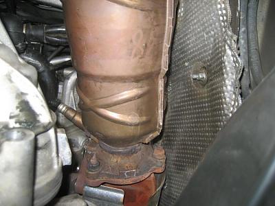

The O2 sensors that you saw from the engine compartment are the rears/post-CAT O2 sensors. The fronts, you'll have to climb under the car and look above the axles on the exhaust to see those. The drivers side is somewhat accessable, but the passenger side is a real pain to get to. Don't know about the cabs but I had to take the axle and the guard around the axle off to get room to get an O2 socket around it with many different swivel extensions. I'll try to post my pics.

Default Here are some pics of the passenger front O2's
Real pain to get to this one. Had to remove the axle.
http://forums.audiworld.com/picture....ctureid=229424
