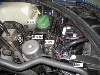

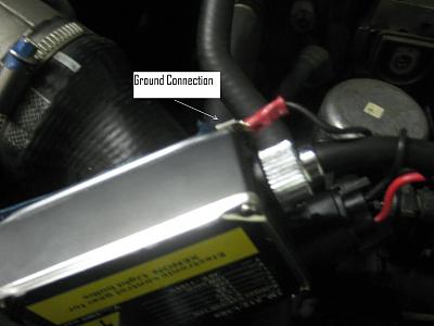

I installed my HID last weekend on my B6 and encountered the ESP and ABS problem same as mentioned earlier whenever I turned ON my headlights. The simple fix I did was to connect the case of the HID ballast to Chassis GND. Seems like the Ballast is emitting an ElectroMagnetic Interference (EMI noise)that affect the Electronics circuitry of the ABS module. By Grounding the case of the HID Ballast you are creating a Ground Shield. I did it on the driver side only as it is the nearest to the ABS module (less than foot). I can take a picture and pos it later if anyone interested.

its been 2-weeks now and no problem so far. Here's the Ground connection I did. Getting ESP, ABS, and flashing brake light error after HID install-hid-setup.jpg

newmdk Just read up above. Ur answers are there. Either reloacte the hid ballast or ground out to frame.

did that start after u installed the hids. These guys are probably trying to scam u. Its a very common problem with aftermarket hids kits being located to close to the abs module thus creating interfernce which triggers the abs light.
