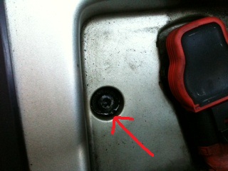

In regards to the Cat being the problem, would the cost be $2000? And the cylinder failure?
I have P0421. I also noticed a tiny bit of oil leak at the drivers side cyclinder in the area of the screw (see pic). I'm guessing in your case the engine isn't actually misfiring? In my case, I am getting occasional misfires, rough idles and jumps in RPMs- on some days, usually after a lot of driving. So, I'm hoping that this isn't causing any other damage to the car. And I'm expecting that the seal is bad and oil is getting into the spark plug causing misfires.
The stock eberspacher cats cost $1,000 a pop, and installing them isn't easy either.
That oil leak is just a valve cover gasket, nothing major there, you should replace them because it will soak the coils in oil. IF your engine actually is misfiring i would just order a set of new ignition coils (all 6) from www.ecstuning.com The stock push down Bremi coils suck and always misfire. Change those first and don't drive the car until you do, because raw fuel getting in the cats are what destroys them.
