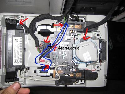

Okay so I just measured the voltage of the Dome and its as follows:
Off = 0V, Door on = 0V, ON = 0.0133V
same thing with the Map lights.
I took it apart again and disconnected everything and reconnected it and no go.
I checked fuses and they're all okay. Doesn't look like anything is messed up on the Dome/Map control board, all the ground are good.
One thing I did notice is that I don't have a wire thats in the pic of the a4mod.com pic. I will circle in blue what I don't have...I want to know if thats an addition they did or if it is something OEM I am missing
anyway, that was never there for me and wasn't an issue before.

that blue line is the hardline for the radar detector. That black cover is the thing im referring too. The part the goes over the map lights make sure that is seated right. If u are getting a dim lit i would say make sure thats snapped in right. I know mine would go out interminetly and i had to pull the assembly and that black part had undone it self enough to not make contact on the grounding points.

Okay I was thinking it was maybe radar or something. Okay I will pull it apart again today and make sure its all seated properly.
