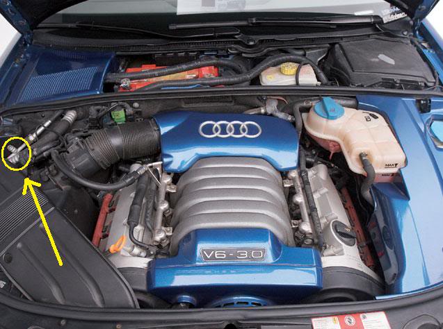

my engine is a 3.0
I can't find the valve.
Where is it located??..I only see one...but isn't that for the AC??
(please note the image is not my actual engine bay)

I just read somewhere that the B6 audi a4 3.0s do not have a pressure relieve valve...theres a 4 bar static FPR back at the tank. Is that true?
If that's the case, would I need to remove the pump itself and apply direct voltage to see if it kicks in?
Size:  88.7 KB thats the fuel rail circled. Im honestly not to sure about the 3.0 engines? But at least check the back of the rails to see if there is a black cap on it. also i love the covers on the engine. did u take them to a shop to get sprayed?

no, i couldn't find any cap or valve.

sidenote: I wish those were my covers...I found the engine bay image through google.
